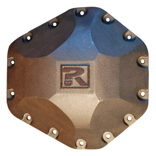

The riddler
And of course the Razorback, everyone knows this cover.
They both run about the same price but the Riddler comes with a lifetime warranty and i like the no lip design. Has anyone run one of these?

i like how smooth the riddler is.
I feel like the razorback is too... i dont know. its too something.

While it's not the "riddler" that is pictured, I use a Crane cover http://shop.cranehiclearance.com/product.sc?productId=5&categoryId=3 that looks nearly identical and I have no complaints. I don't see the downside to these cast covers being that they are made of chromoly (not iron) that is 1/2" thick and are at least as strong as the cast iron housing they are bolted to. Really, either cover will be strong enough that you should never be concerned with failure even with no expressed warranty.
