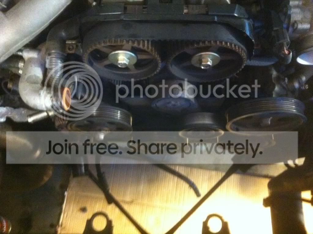

My brother is fixing his car up a bit. Thought I'd be big bro and help him out a bit :waytogo:
Anyway the bottom pulley on his motor is wobbling as though bent and the nut seized on pretty bad. Now, the nut is not damaged beyond removal, yet.
How would you remove it? I was thinking of trying heat and then using an impact gun. Only thing is I'm not sure that the pulley will stay put (might spin).
Get the appropriate socket on a breaker bar and lay the breaker bar against the frame and crank the engine and the bolt will come right off (assuming the bolt isn't rounded and allow the socket to slip off).

4 cyl Hondas (maybe not 100% of them) run counter clockwise and the factory bolts are tighter than Frenchie's shorts, but still right hand thread.
Looks like a Supra.
The prybar trick works, so does heat. Remember is you heat it up replace the crank seal too.
The heat will be needed to break the locktite loose
Oh yeah an impact gun would be fine. The pully maY move a little, just let it do its thing. And if a manual leave in gear

Just gonna have to try the impact correct socket and heat.
There are a couple of tools to hold the balancer (crank) but its a little tricky to explain.

And leaving the manual in gear would work, but make sure the brake is set hard, and the wheels are chocked....or you'll run yourself over...

Negative again, just about every engine turns clockwise with the exception of reverse rotation marine engines and possibly a couple others but not a Honda.
You cant hold an engine from turning with an automatic,there is no direct connection in the torque converter ,just fliud...maybe if you devised a way to lock the converter clutch if it has a lock up one ,you could...but an impact should spin that bolt right out--I have used one to remove a hundred altenator pulleys,using nothing but a gloved hand or a rag under my palm to hold the pulley still...you could use a strap wrench to keep it from turning too...
