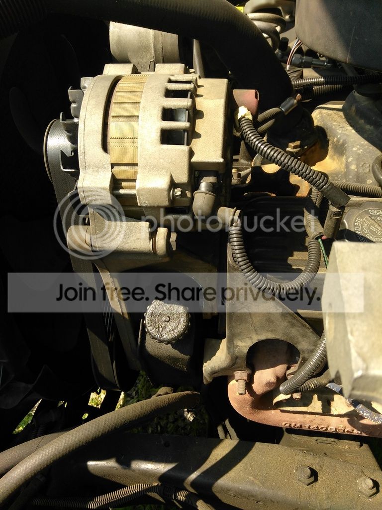

Here is my '95.
Here's the steel bracket for the alt and ps pump. You might be able to see the dent just behind and above the ps cap.
The dent allows you to get a box end wrench in to loosen that bolt with the pump still on the aluminum bracket. I think most
people leave that bolt out but the aluminum can crack with out all the bolts. I also slot the holes for the steel bracket at the
manifold (they might be that way already I can't remember). I can get more pics if you need.
As you can see from the above pictures, both brackets bolt to the back of the belt tensioner. Then one to the boss in the front of manifold next to sensor and the other goes to the front manifold bolt or stud on drivers side. The metal bracket is held on the exhaust manifold and both holes are slotted at bottom.
