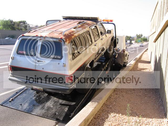

Just a few years go, I had to go rescue my mother while she was on a 150 or so mile road trip to go visit someone, she was on her way back and called me to tell me she was on the side of the road with a major power steering problem, fluid leaking out everywhere and whatnot..
I automatically assumed the high pressure hose... So after calling around for an hour or so, trying to find this hose for a '94 Silverado with a 4.3v6, I found that Carquest had one in stock, went & bought it, drove about an hour out of Phoenix to where she was, looked over the problem and realized all hoses were fine, but the front bearing of the power steering pump had siezed and come apart. Essentially making the truck undriveable until the pump was replaced, because naturally, everything else needed that belt to run, charge, stay cool yadda yadda... I was not happy and ended up tow strapping her and the truck all the way back to Phoenix,, something like 60 miles.

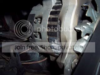

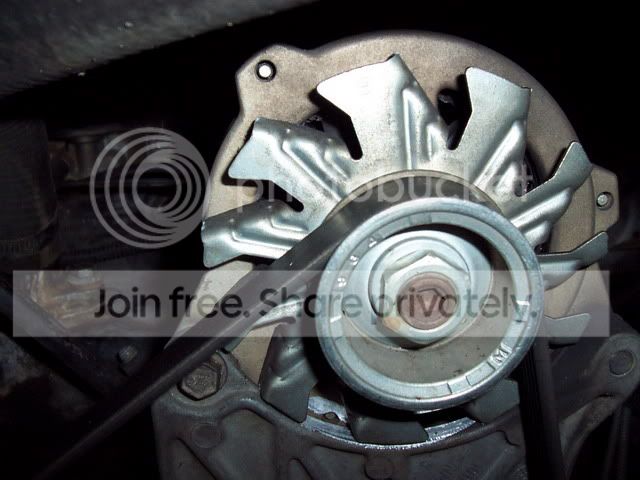

ALSO,,, as mentioned previously in one that I did read in here,,, I did at one point have an alternator bearing let go and actually had a small fire inside the alternator when I opened the hood,, again, stranding me on the freeway, luckily I was inside city limits, but was still in need of this type of rescue.. :doah:
So did the bearing go out enough that your alt fan was rubbing on the aluminum bracket apparently? Do you think you would of made it far enough to matter with no alternator? My battery would go down pretty fast when my alternator went, even before I had EFI, I did have electric fans though. Mine stopped charging but would still spin without a fire. What actually happened is the internal plastic fan exploded, and the alternator burned up inside, then quit charging. No fire though. I could probably drive for about 15 minutes before I would get in danger territory of low voltage. I drove far enough to charge it up, then drove it back to where I could fix it.
I hate it when stuff like that happens, I have to admit, in the back of my mind, the power steering pump going out is definitely a concern, I have even tried to see if I could get a belt length that would bypass the power steering, with no luck, because that's really the only thing that could screw you where you would be OK with the Vbelts for quite a while, but I still think all the pros outweigh the cons, especially since the chances of that are pretty low, especially with proper maintenance and no warning. But sh!t just happens sometimes.
I know I could have driven the rest of the way home without the alternator belt, IF I had V-belts, really I was only about 10 miles away.. and yes, the alternator cooling fins did make contact with the mounting bracket, front bearing was totally destroyed.
