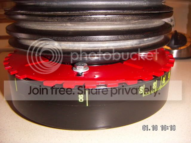

Can you bolt the crank pulley bolt onto the old harmonic damper or do you have to use the damper off the serpentine engine?
Well I've seen some where the pulley is part of the damper, but I don't know if that's specific to LT1, LS6 or something else.
I have been wondering if I could convert to serpentine without losing my crank position sensor (which is on the damper)
The very early 283's had the pulley riveted to the harmonic balancer but every other SBC up until at least the production of the LS series engines had a bolt on pulley. What engine do you have?

I have a Goodwrench 350 with 8" damper. The ones I'm thinking of must be LS-series engines, then. Good to know. I have the triple V-belt pulley now.
