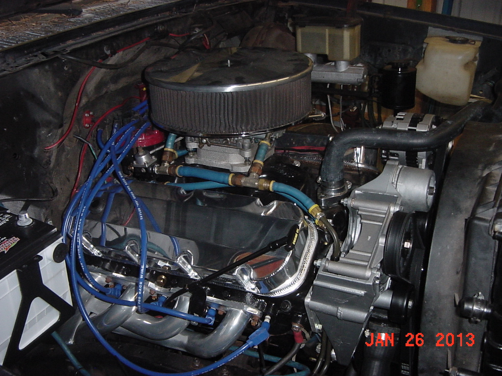

Here's a few pics for you @Ned Kelly , this is the 454 in my Blazer.
Edit: I should explain better - Kwik Performance makes a bracket kit to put an SBC serpentine set up on a BBC. The only odd part is the crank pulley which KP provides a part number for.
Kwik Performance conversion brackets
full
Everything on the motor
full
Better pic of the a/c delete pulley (motor fully dressed)
full
a/c delete is just that bolt on bracket and pulley were the pump would be .
kwik performance has a super nice kit . and NOW offers a spacer to use the sbc pulley and not try and find the gm rare pulley .
