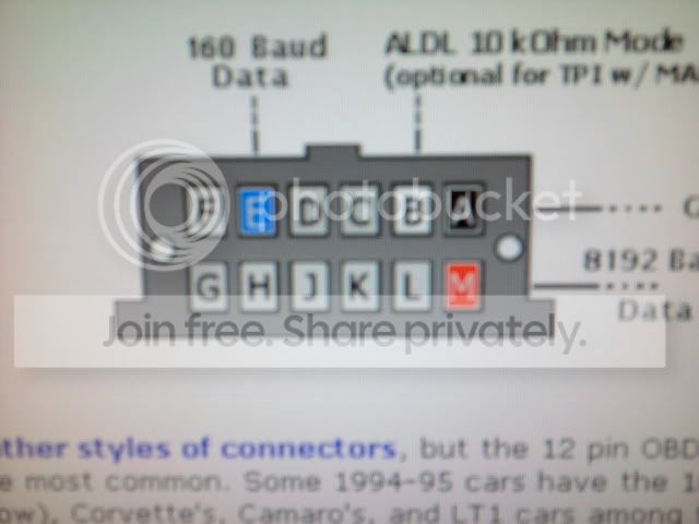

I have a service engine light light coming on in my "new" 1988 suburban, 114k miles. it was coming on then going off for the last 80 miles, now it is consistantly turning off about 1.5 miles after starting and is now staying on until i shut it off. It didn't do this last fall before i stored it in a field over the winter.I know it had a dead idle air controller, sometimes it stall on start up and needs to be pedeled, sometimes it revs to approx 2000-2500 on start up. this doesn't happen when the motor is warm.anyways, how do i pull the code?
Hit the link in my signature to the buyers guide, directions are at the bottom. :D
is there a way to check a code without shutting off the engine? the light is always off when i start it, have to drive a mile or two before it comes on.
Put a paperclip between A and B on the DLC. Turn key to acc mode (dont start engine). The first 3 codes will be 12 to let you know its in diagnostic mode. Will flash once pause and then flash twice (code 12) after 3 code 12 look at the next code that flashes that will be your trouble code. Very easy.
When the light comes on, the code that is set gets stored in the computer.
turn the truck off, connect the a-b pins, turn the key to the on position but do not start, the light should start flashing. 12 three times, then your code for whatever is faulting, then 12 three more times to finish the sequence.
