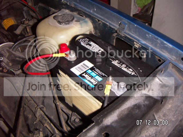

Marine battery is installed. Nothing but the absolute best!
I won't have anything on this battery my life depends on, so I'm going cheap to see if I need more later. Do I really need a $230 Optima when these are $60? I stuck with group 24 because it fits in the tray. A real deep cycle might make more sense, but this is rated at 600CCA, which works as a backup plan should I kill the main battery.

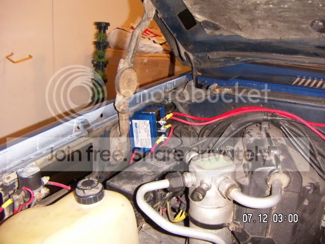

Battery isolator installed:
Right next to my Ford solenoid and my Ford electrical center. (I also have Ford Racing injectors and Ford ignition in case anybody is keeping count). This is only a 90A unit, but it is only connected to a 63A stock alternator, to charge both batteries. The OTHER stock 63A alternator is charging only the main battery.

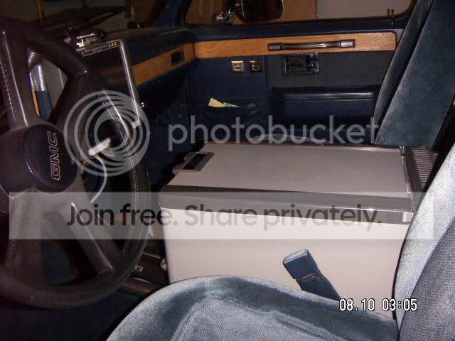

And now I'm happy to report more progress. Refrigerator installed:
This is a Norcold Tek II, which is the same as an Engel or ARB fridge. It is just ratchet strapped to the seat bases (I flipped the handles upside down to make this work better). Since the cigarette plugs are wired to the aux battery, it simply plugs into one of them.

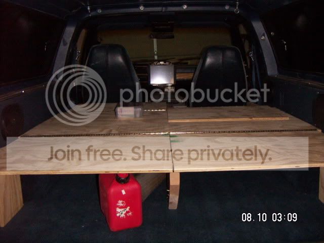

The sleeping platform is also complete:
The four sections flip up to access gear underneath. I used piano hinge for the low profile.

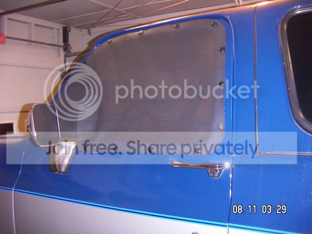

Progress from yesterday. A tube of this:
Plus a roll of "Solar Screen" from Lowes:
and a couple packs of magnets:
and you can build some ventilation:
I have a design in mind for the back window as well. I also cut some of this to cover the side topper windows for privacy:
