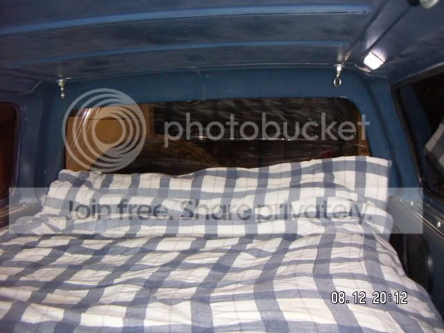

Home Sweet Home!
The bed is just shy of 6', so the bedding gets piled towards the back a little for driving. We're about 5'9" and 5'7" so it's fine, but for 6'+ people it would be tight.

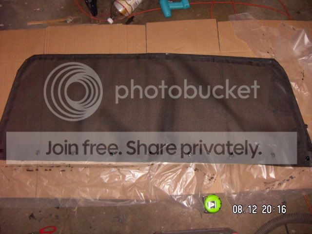

Here is the screen for the back window.
The top and sides are just rolled around a piece of plastic tubing and secured with the weatherstrip adhesive. It gets shoved into the hard-top window track just like the window would. Then the magnets on the bottom edge stick to the inside of the tailgate. I had considered making a solid insert out of hardboard or something (with little windows cut out of it), but decided that something flexible is a lot easier to store.
High winds will be the real test for these screens.

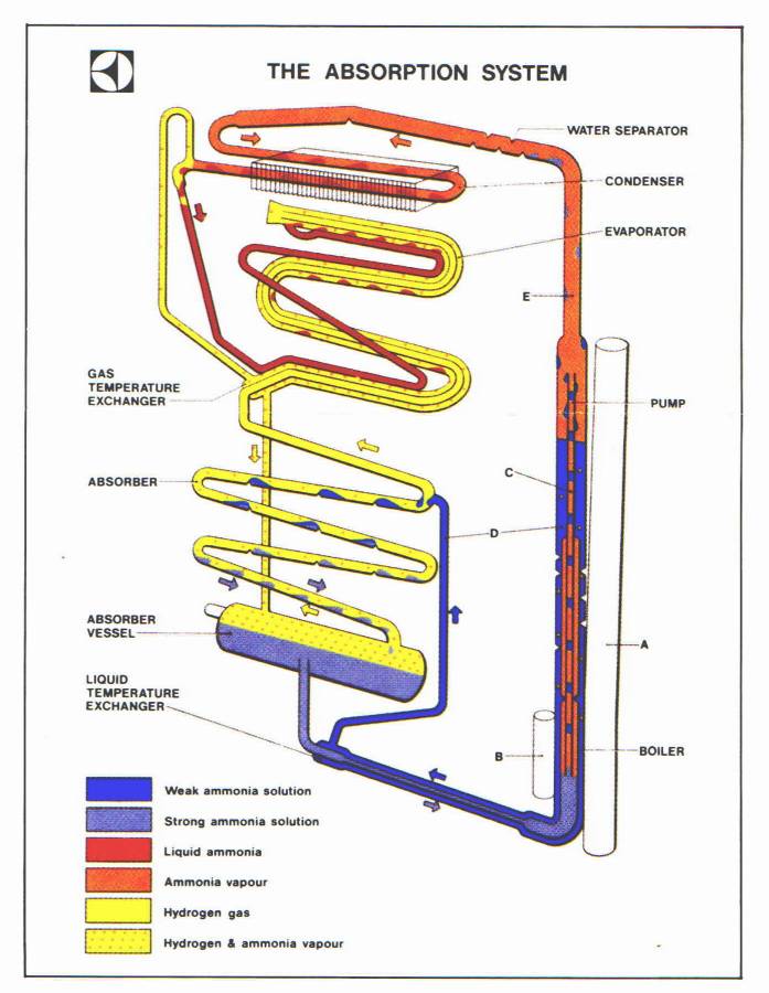

What's the scoop on the propane refrigerators?
What kind of information are you looking for? A propane refrigerator uses a flame to boil ammonia and create a cycle of physical and chemical reactions that move heat from the absorber to the condenser without any moving parts. Before the compressor refrigeration was invented, this is how all refrigerators work. Now it is mostly used in RVs.
Although they run a long time on a little propane, I don't know how to apply one to a car without cutting holes for ventilation. Dometic does make a portable one, which would be awesome for extended camping, but I've never seen one. I assume you could strap it in a pickup bed and let it run back there while you drive.
