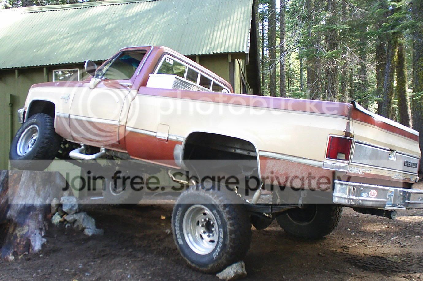

I run the shackle flip/4 inch block combo in the rear. I am very happy with that setup. What I am not happy with is the sagging, stiff, and just plain crappy Superlift 8 inch front springs so those will hopefully be swapped to BDS springs soon. I have to go to Sacramento to get BDS products but it is worth it. But the shackle flip/block is a good combo, you might need traction bars if you are pushing a whole lot of torque. This is the best pic that I have of this setup sorry.
