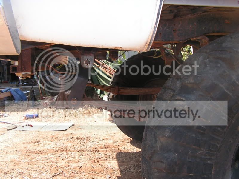

I may as well pic whore my DIY4X flip as well. :D
blog_attachment.php
If you are having trouble sleeping and don't have any propofol handy, try reading this. :D

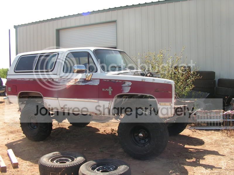

might as well post up my junk
ord shackle flip(swapped sides), diy4x 7" shackles, 56" springs no overload, diy4x ez inch.
