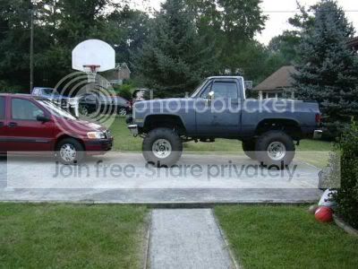

Wow.. haven't posted here in years (since I sold my blazer :( ) but anyway here is a pic of the old echobit shackle flip that I used with stock rear springs.

It did great for me. I mainly did mud and trails and didn't notice any excessive movement.
Awesome. Thats the same thing mine will be used for. This is just going to get me by so i can afford a ord shackle flip. I payed like 40bucks and it came with ubolts.
Mine is a DD. Did yours ever get driven on the street?
Yep, it was a daily driver. Go with the ORD if you like later on but this shackle flip would not let you down.
