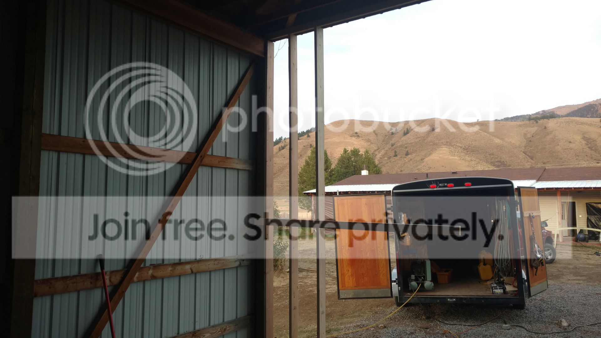

First header question.
2 12' ft wide doors with a single man door.
Going in this opening
From inside
Am I right in thinking the header doesn't need to be much? I was thinking a couple 2x6s glued and screwed together.

For the Garage doors you will need a taller header, not for strength to hold stuff up just to allow a large enough area for the door system to attach to correctly. I would just do a couple doubled up 2X12 for good measure. For the man door a couple of 2X4 will suffice.
The Header for the post in the back will probably end up being a 14" tall triple LVL header and maybe more? If there is no real difference visible between the truss that clear spans the front area now and the last truss above your back wall you are really only going to be supporting the new roof load and a minor bit of exterior cladding load that is already there. Shear resistance comes into play here but some plywood on the inside of the remaining area will probably suffice.
^^^^^ What he said. For the rear wall, as mentioned, if the trusses are all the same then there isn't much load on that post. The strength/requirement of the LVL will mainly depend on what is going in the opening. If it is just going to be an opening then the 14" will be more then enough.
I'm not sure what I can add, but I think I used a couple of 2x12's for my header over the door. It's not holding anything up but the doors, so I can't imagine it needs much.
