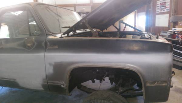

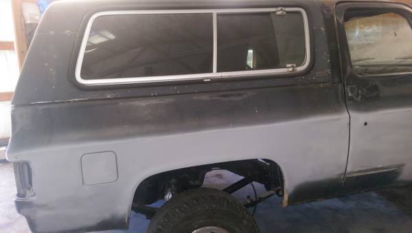

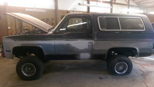

I have been vacillating between a Scout and a Blazer for a while now. Decided on the Blazer today and I already looked at this one once a few weeks ago.

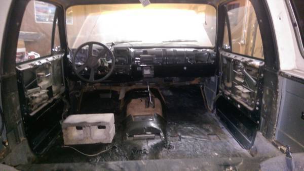

It came with the original seats, new door panels, new dash pad, new shocks and stabilizers, a cowel hood, lots of little things in boxes and it already has new 4" lift kit and new brakes and lines installed. I don't see any rust anywhere and I spent some time underneath it with a bright light before laying down the cash, all $2250 of it!
