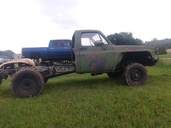

I have a convertible conversion kit off a rusty 1974 that grabbed because it seems like if I chop the roof off a later model I may not find another. I also have a set of axles from a military K5 with 4.56 gears and 315/70-17 tires on nice wheels.
if those axle are from a military K5 they will have 3.08 gears (10 bolt /10 bolt combo); the only way they would have 4.56 is they were regeared or are actually from one of the pickup variants they military used (Dana 60/14 bolt combo usually).
They are from a M1028. 14 bolt Detroit Locker in the rear and a Dana 60 with a Trac-Lock up front
