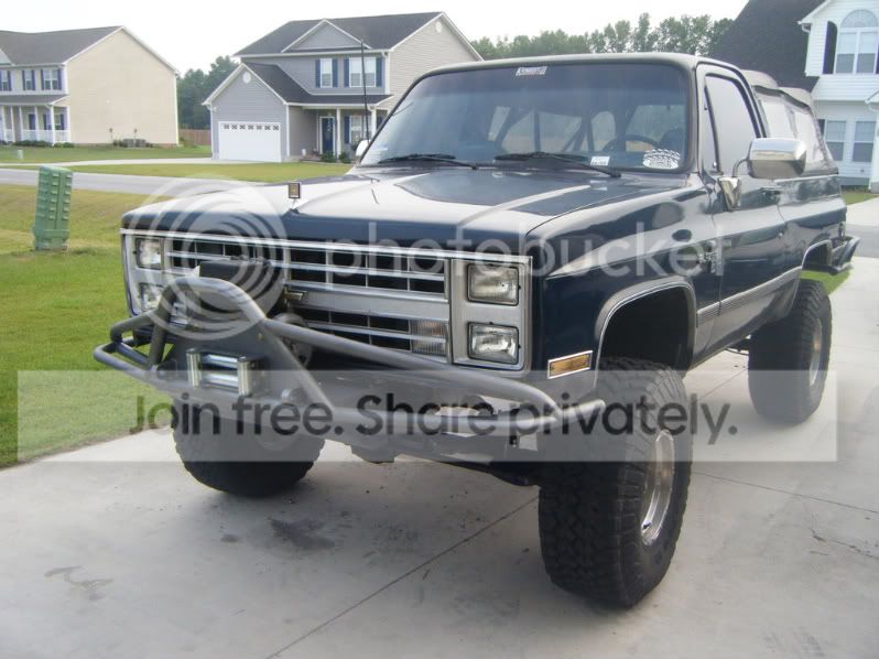

kota4bye runs one on his truck.you might wanna pm him.here is his set up
