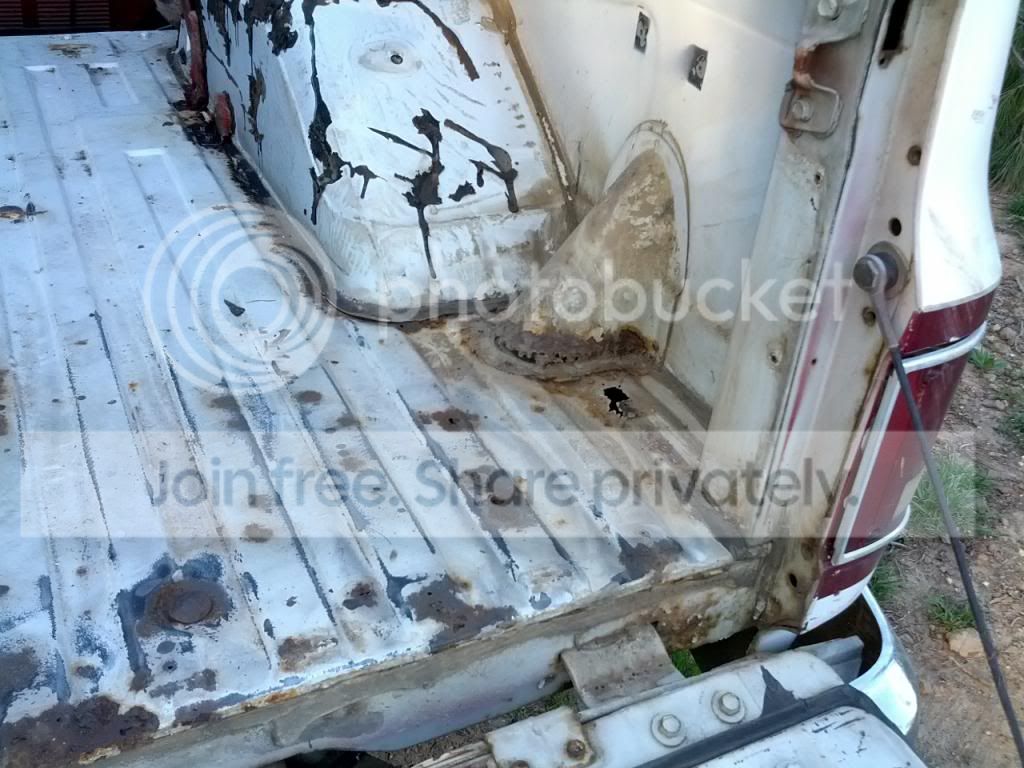

So I'm tearing out the carpet and want to bed line the interior floor. I have some rust issues here and there that need to be addressed, but I won't be able to get to those for a year probably. I planned on just wire brushing the rust, tagging it with rust reformer, scuffing, cleaning and applying, and what continues to rust and chip, does. I imagine the front has some spots as well, just haven't tore that out yet (cause my trash can is full :doah:) Well I'm sure it does anyway, I know my rockers are toast.
Will it make it a pain later to get the spots fixed? Figure I could just bring the areas that need replacing back to bare metal, make the repairs, and re-apply those spots. I mean it's bed liner, should apply and "feather in" decently, it's no show truck. I don't care about the rest being a year's faded in color.

Man, sounds like a pain to bedline then fix later. But if its not in the cards,you gotta do what ya gotta do. Floor patching is a time consuming process for sure.
Yeah, I figured it'd be a PITA to remove it when I'm ready to do the work. But I know I won't be able to get to it for a while, just want some kind of protection on the floor. Took the topper off the other day, it'll be staying off until about October.
Guess I could knock off the rust where I can, some kinda rust encapsulator then put some rustoelum on, till I can get to it? I mean 30 years to get to where it is now, up to another year won't really matter, at least now it's not under carpet.
Just leave it till your ready, I wouldnt even mess with painting or rust encapsulation, good place for the water to drain :thumb:
