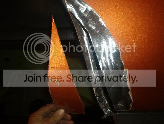

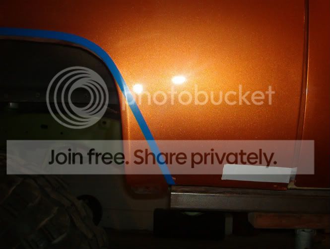

mark, measure, cut.... start on the outside and work your way in... mine is about a 1/2" below the door and 3/4" sticking out....
pretty sure I'll be ok jacking on that.......... :wink1:
or dropping it on a boulder..... :haha:

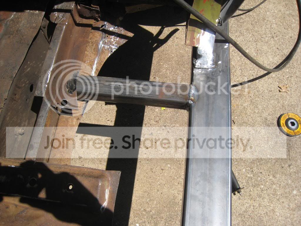

One way to do it, although not as bad ass as Ryokens is to slice out the area for the 2x4,
tack in the 2x4. Then you can take 2x2 square and tie it from the 2x4 right into the form near the body mount.
Crawl under there and it becomes clear. Done even this way it can take a serious amount of abuse. I recommend at least 3/16" or 1/4"
-shawn

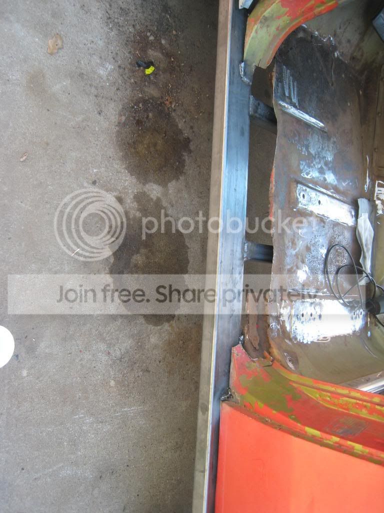

Heres mine done on a truck, I plan on redoing them soon to extend them to the front but when the truck was built we had some scrap and it happened to be almost the right length
here is some from the inside, I have never felt the need to mount rockers to the frame if there is enough of the body you can put them on. Never had a problem with this either
