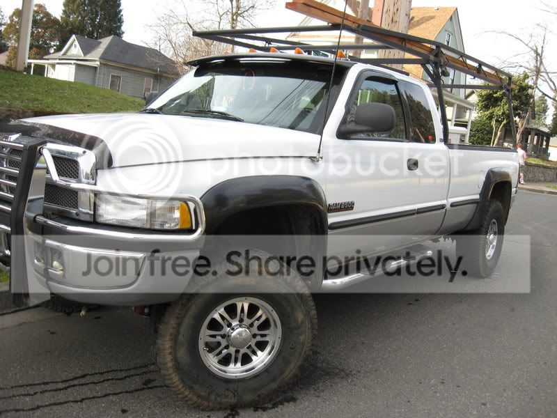

Heres mine, its the only pic I could find. I can take some rack specific pics tomorrow if ya want.
I have had many different types of racks, and visually, I like square tube the best.

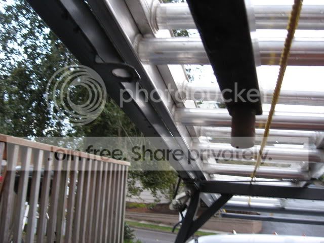

mine is great because theres lots of places to hook to with the little round bars.
One thing that is a must: allow the rear bar to be removable. Mine actually swings around and locks in, which rocks. A center support would be nice too, but it should also be removable.

I'll go out and get some pics of this one for ya.
