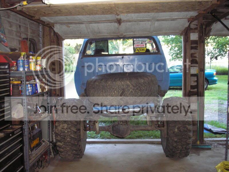

id like to see some too, when i did my shackle flip i had to lose my reciever. i plan on drilling holes in the frame and mounting tow hooks front and back.

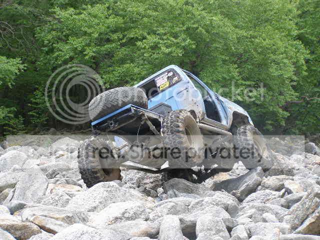

Not sure if this helps you but on the rear i have a low-profile hitch from Summit. I love this thing, it looks good, didn't ruin my departure angle and it's strong. It bolts flush with the bottom of the frame and i think it can work with a shackle flip. The front is the old Warn Classic bumper with the hooks mounted under (the bumper pic is from when it had a 3 in body lift).

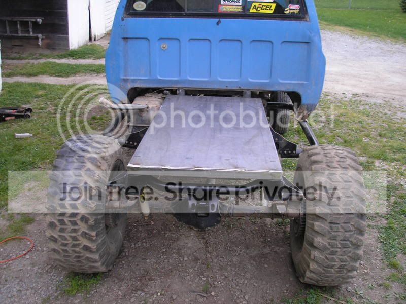

This pic shows my brother's 79 with the hooks mounted sideways after cutting the bumpers

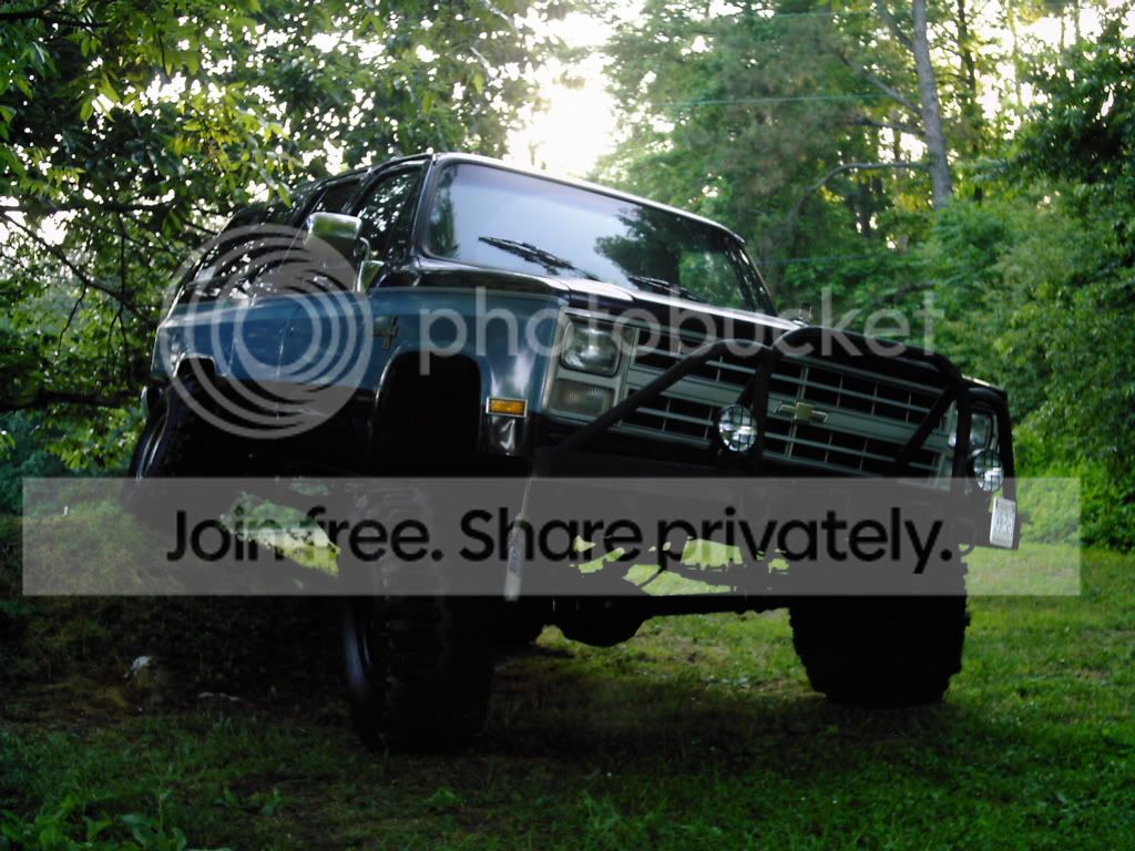

Here's mine They are ford superduty hooks mounted to the frame horns. I have since done the same thing in the back since I removed my reciever.

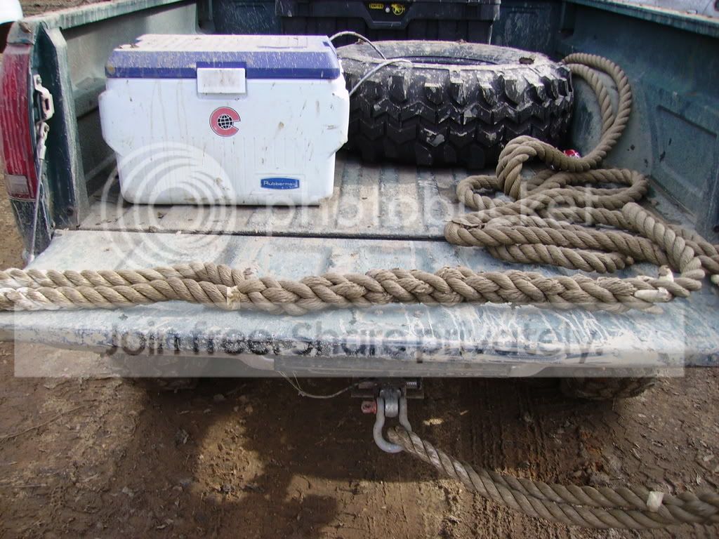

Factory tow point with a 8k D shackle though the hole. The hitch pin style with a cotter key.
Front still uses the factory hooks. Had to modify the push bar a lil to make it all work.

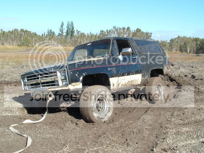

I put A 20,000 lb D-ring on my bumpers after losing a front bumper with no tow hooks I seriously upgraded.

i personally lost mine because it was in the way of my shackle flip brackets. shackle flip is way more important, so off it went.
Dig the tail lights, they LED?
