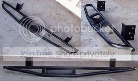

Use rocksliders with a lower bar for a step. Keeping it continous prevents you from getting hung up on the step. Here's mine:
Don't do the chains, "been there, done that".:doah: If you do any mud riding, they get caked up and are slick as owl sh!t. They will also catch your foot, especially if you wear any type of boots with a heel, if you're not careful, which could twist an ankle. Plus, if you mount them to the rocker, they are too far under the door, which causes you to hit your shin on the rocker. I yanked mine within a couple of weeks after installing them.
