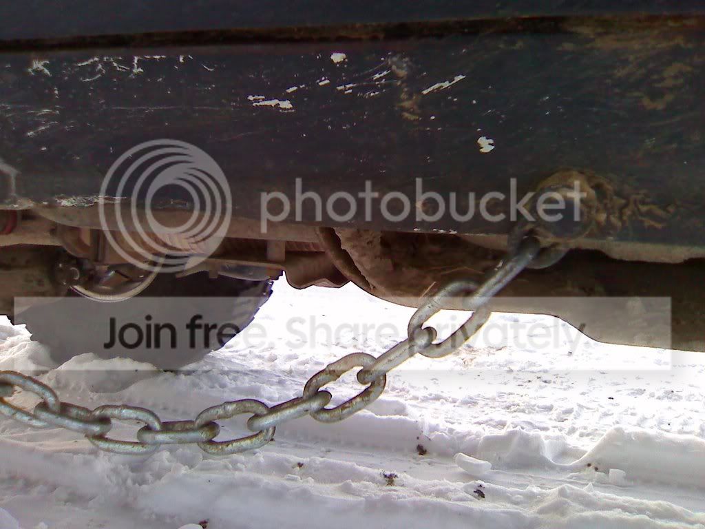

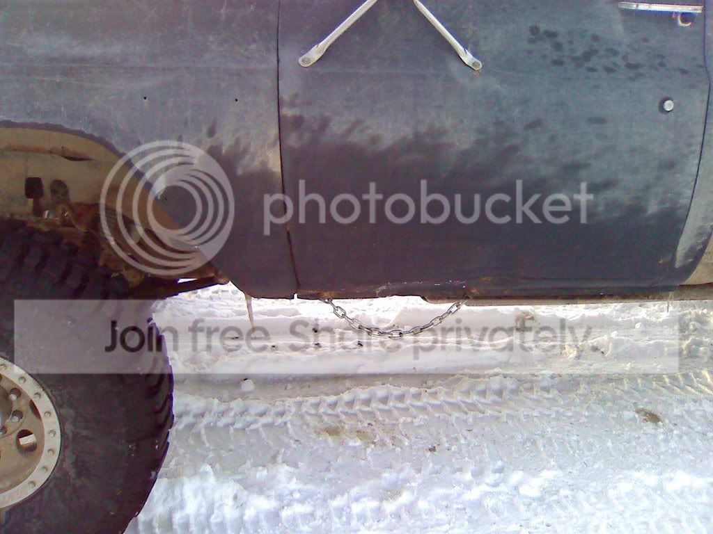

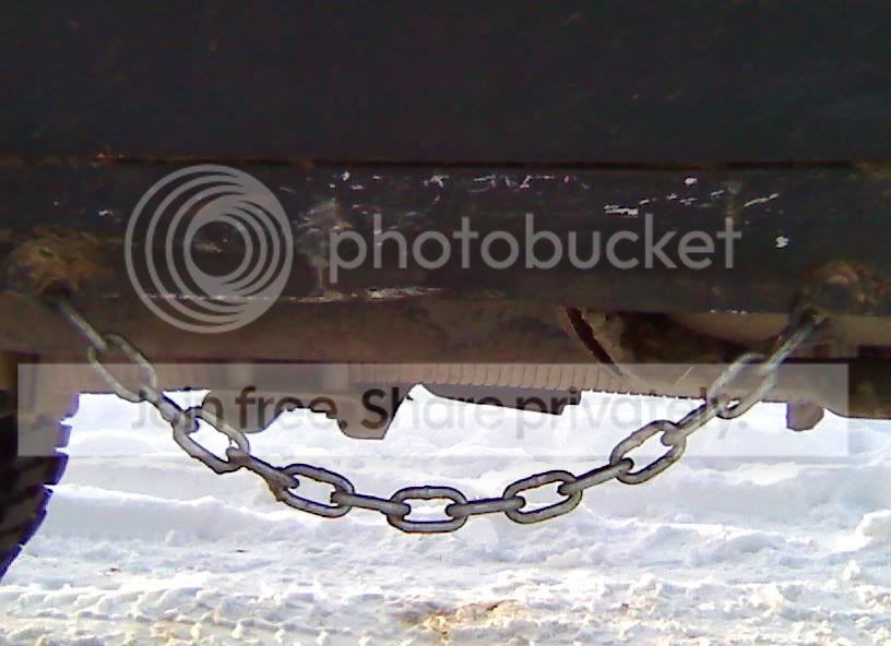

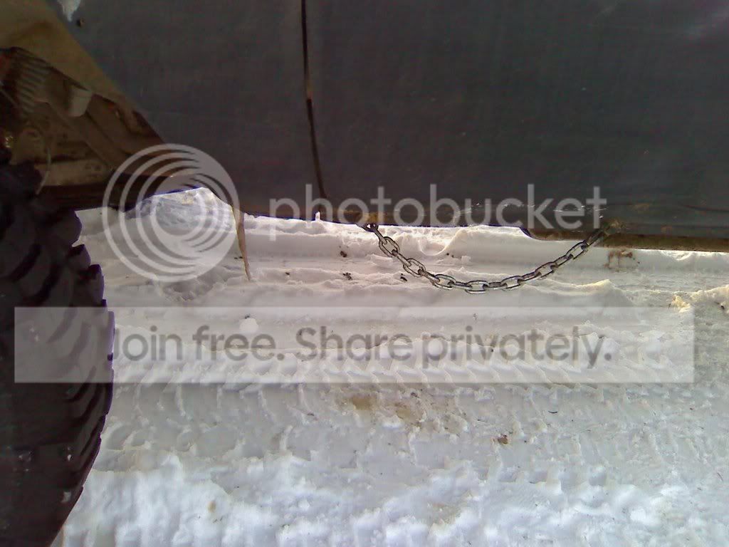

I used about a 20" length of cheap ace hardware chain, drilled a couple holes on the lip at the bottom of the rocker and bolted the chain on. It has about 4 or 5" of sag in the center so you can get your foot in and it won't swing away and leave you hopping around holding your shin. I came down pretty hard on a rock and smashed the rocker and my door in and all that happened to the step was some scratches and it wore some of the bolt head off. My vote is for chain it's cheap, easy and I don't have to listen to the wife complain about not being able to get in the truck.:D

It has been covered on here before, try searching for "chain steps". I'll post up some pics as soon as the wifey gets home with the camera.
I put them forward like that so when the weight of your foot is centered in the chain you are not trying to get your other leg in the truck from way back towards the rear of the seat. When I use the one on the drivers side I put my left foot in the step then step into the cab with the right and vice versa for the other side. Thanks for the comment, but I still have quite a bit of work to do to get the truck how I want it.
