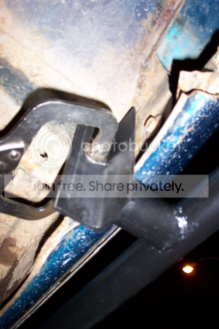

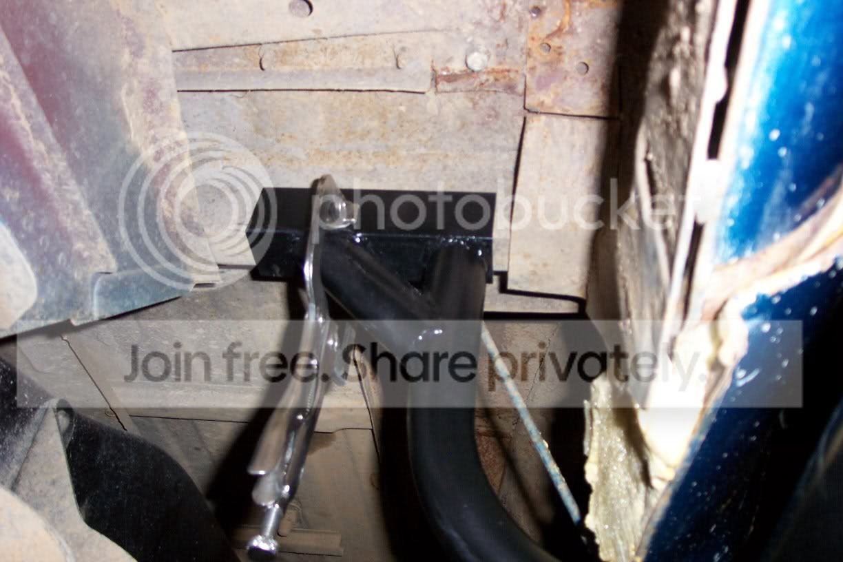

    Why does everyone mount them to the body (Tdawgs look like most - angle iron to the body) instead of mounting them to the frame?
  18. balterbuilt
    balterbuilt 1/2 ton status
    Joined:
    May 10, 2004
    Posts:
    385
    Likes Received:
    Location:
    Santa Rosa
    because the frames on these trucks twist like a spaghetti noodle. They are not rigid enough. Imounted mine on the frame and they still hit the body leaving marks where the side bars came out. the body it rigid. Mine are mounted to the body braceing (bolted) which is the strogest part, unless you want to cut out your rockers and weld them in, then that would be the strongest way. Just do what you gotta do and tell your wife you got it off ebay for 100 bucks :-)

    Is there a problem with attaching to the frame and bracing to the body?
  20. balterbuilt
    Joined:
    May 10, 2004
    Posts:
    385
    Likes Received:
    Location:
    Santa Rosa
    this is how i mounted mine, fee lfree to rip off my idea if you don't want to cut your body apart...
