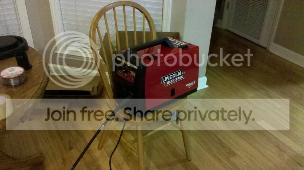

Lincoln 125 HD Now just gotta get all this homework done so I can start perfecting my horrible welding skills
AHHHHHHHH YEAH!!!!! Your about to have some fun.
I just talked to my welding teacher the other day so Ill give ya some good tips to start ya off with.
When welding with flux core you must drag the tip, you cannot push with it because of the flux coating on the metal. So point the tip back at the beginning of the weld and drag it while keeping it pointed back. Also you want the tip (the inner copper tip) to be 1/2"-3/8" away from the surface of the material. with that, and figure out some welding patterns, (I prefer a small circular pattern) and you should be rockin.
Now go weld some SHHHHTTTTUUUUUFFFF!!!!!![]()

Ok if you havnt used that welder yet ima come kit ya in the neeeeuuttssss!!!![]()
They's no need in all that! I have welded all the scrap metal I can find laying around together, fixed my exhaust hanger, and begged my grandpa for some of his metal
JK man, looks like you are having some fun now!Nice! That's the welder I have, it's been great so far! Also, on the coatings subject, look up KBS coatings. Apparently it's phenomenal and costs less than por... The guy who started the company used to work for por-15.
