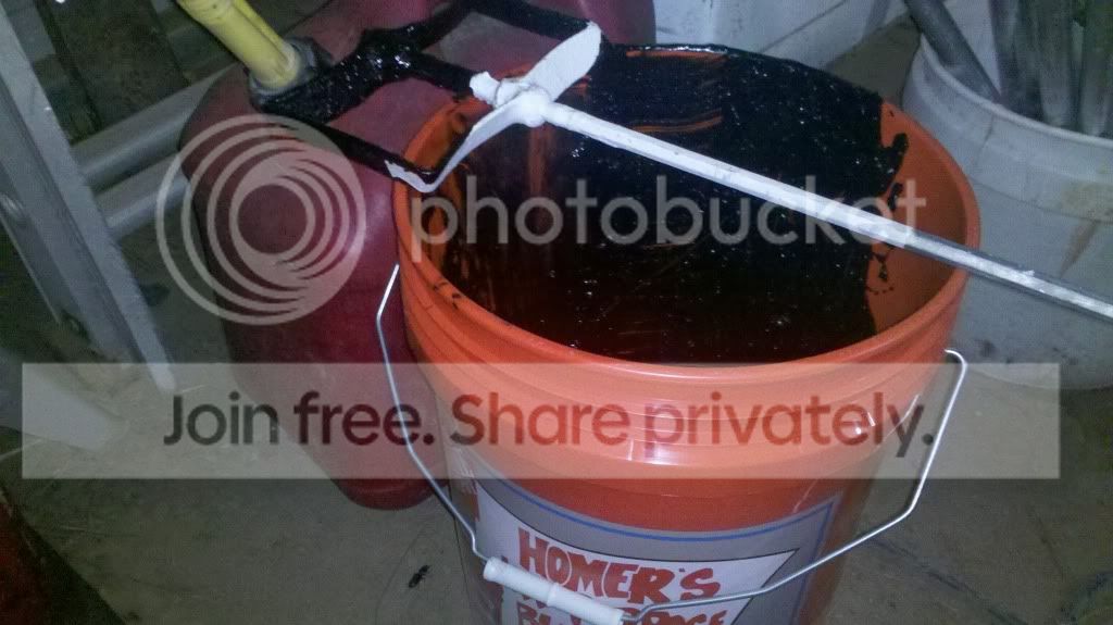

I recommend ordering just the bedliner mixture and whatever rubber you want with no gun. I used half bag fine rubber with half bag of coarse.
So in that pic of "whats left" those are all full? Hmm I see I see.. Looks to be pretty gritty, how does it feel after its cured? Im not goin for looks, I just want something to really protect under the carpet from moisture...
Looks good though!!!
Yes those cans are full , I had 6 cans total at the beginning. One of each can mixed together in a 5 gallon bucket, add rubber and mix with drill and thing on bucket haha can't think of the name.
As far as texture wise its pretty hard to the touch. When I do the tacoma bed and speaker boxes I am going to use all fine rubber instead of the heavy crumb and spray it on thicker being its a smaller area.

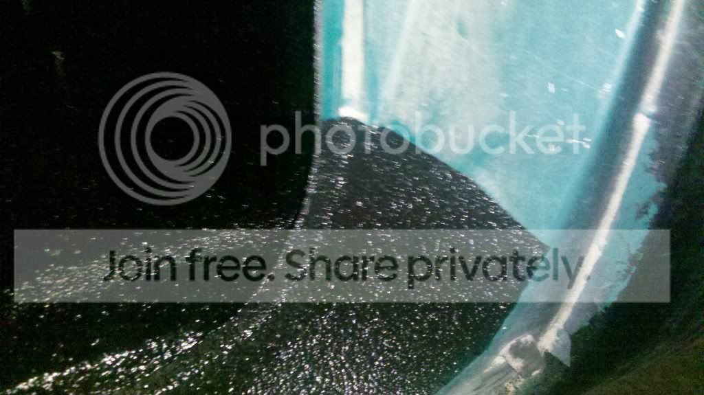

On the sides of the rear walls and the less traffic areas aren't too thick like 4 or 5 passes but in high traffic areas like where your foot slides getting in and out and at the heel pivot point of the pedals it's got probably 10 or 12 passes there.
I think I posted a pic of the door jam earlier and that's like 2 passes when the tape pulled off.
The first pass wont even cover all the color. The second will give it a solid black color and then each coat after that thickens it up
2 coats and the tape removed
