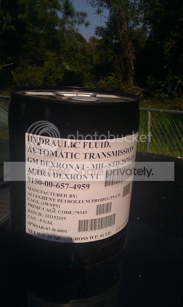

I did get a 5 gallon can of Dexron VI for free ninety free. $6+ per quart at vatozone.
Having friends in the right places is a great thing. :pimp:
