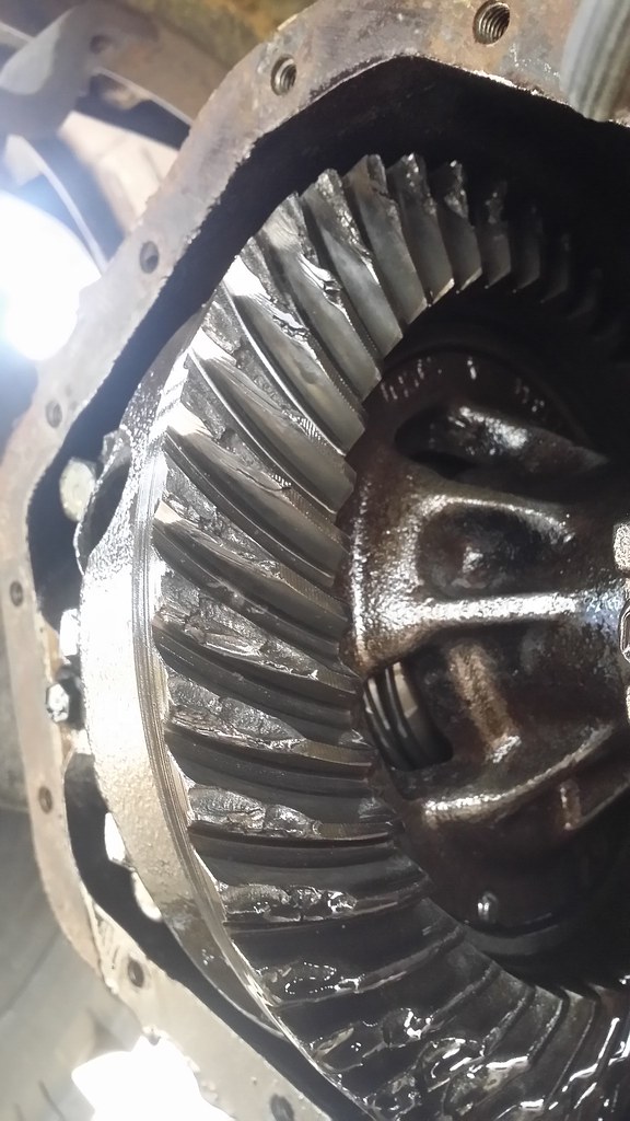

hahahahaha... that pic was just a placement... youtube doesnt let you upload audio only.. so i took a pic and placed audio to it.. so it would go to youtube
Ok, I guess that's easier to see on a PC than a phone.

1978 r&p vs detroit locker by
Jeffrey Riggs, on Flickr
That's no good either. I guess if fix that first then go from there.
