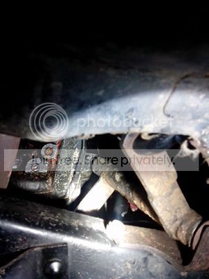

I bought a k5 that was an unfinished project. I added my 4.56 axles 36s engine trans ect that went from my old 86 I rolled that went into the new 88 body that had a 3 inch body lift already installed. running a manual trans and until now oe style clutches. lengthened the big rod 3 inches and have had a new problem of tearing up clutches and throwout bearings very rapidly that the stock body height 86 never had so ive gone to a dual fricton centerforce. noticed today that it seems to push the fork down and then into the pressure plate. that Normal? I need some pictures of the mechanical linkage z bar angles of a stock and properly converted body lifted truck to compare and make sure mine is correct. and whats the exact length of the rod after being extended? mine seems to be about an inch short even after extending it 3 inches. its causing the z bar to sit higher than it did stock and I have less adjustment on the threaded rod going to the fork itself

The easy fix is to go to a hydro clutch. The angle you are putting that rod in makes it less effective to the point of not completely disengaging the clutch as things wear.
