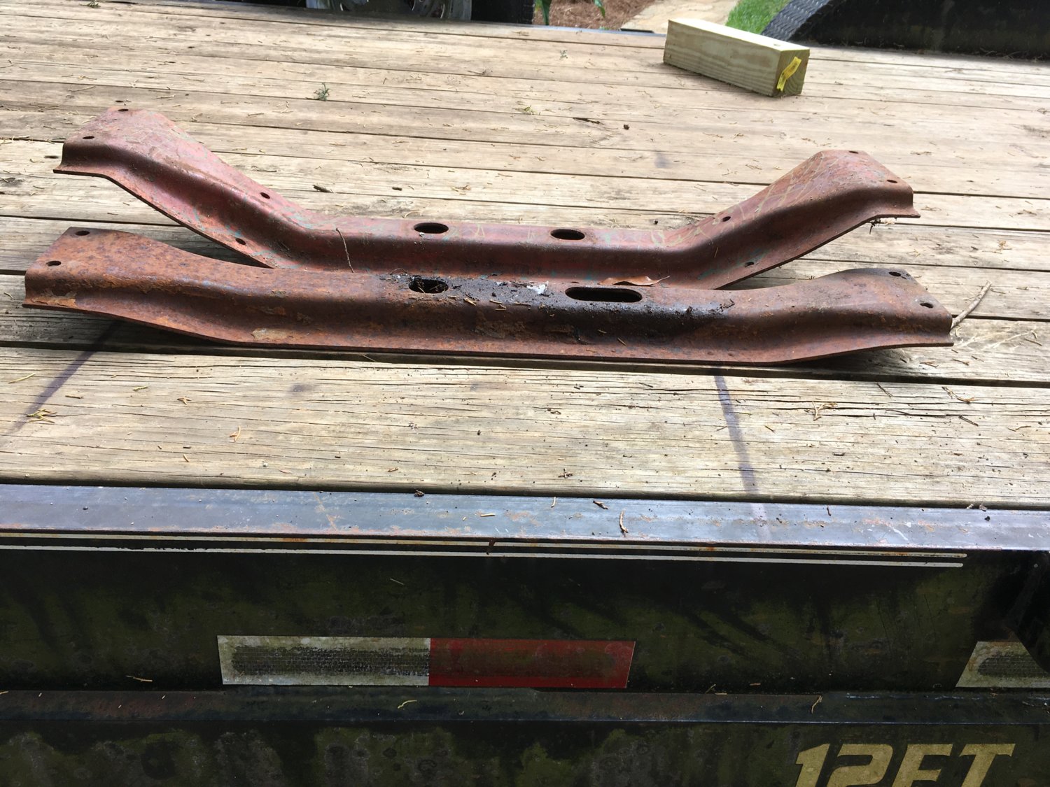

Just for his clarification in identifying the crossmember the one that we all call “flat” for the long foot mount adapters of 73~84 K5,10 & 20 variety does have a raised section on each side where it attaches to the frame just as that first picture shows - this is the most common one made.
Like Wes said - beware of a K30 crossmember that is truly damn near flat from 77~84 as this will not work.
If your running a figure eight NP205 then you are look’n for the one in that first picture just as the others have said.

@Tufftruck69 The crossmember in the foreground of this pic is from a K30 and ONLY fits a K30 frame. The crossmember in the background is from a 69-72 however it is basically the same as a 73-84 K10 or K20 crossmember.
