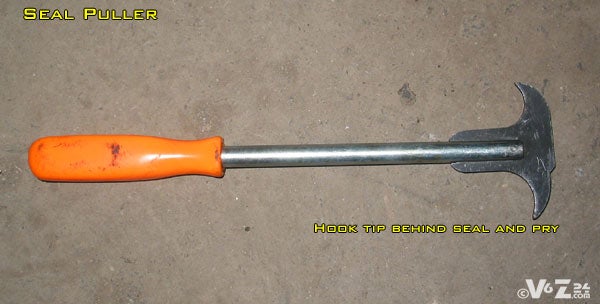

As far as the seal puller tool goes - I also in the past have had no luck with them and old seals. Being that old seals are rather stubborn, the puller tends to rip right through the rubber of the seal. Technically, the puller tip should be pulling on the band of the seal, which would possibly lead to gouging the inner housing lip.
Go with a hardy flat tip screwdriver. Lay it across the spline drive shaft - Straight across. Where the tip of the screwdriver finds the seal, tilt the screwdriver in, towards the back of the seal. Slide the screwdriver into the housing and try to "bite" the back of the seal's band.

Yeah sorry, went kinda crazy over the last few days with the posting! I ended up getting the seal out, i got that big double headed hooked seal puller by craftsmen. At first it looked to be too big for the job but within a minute i got it hooked in the exact spot you described and pretty much rested the other head of the hook agiast the case and just used some leverage and out she came. You can see the dent in the back of the seal where i hooked it. But, everythings back in and no leaks! just took my twelve hours, 9-10 of those dissasembly with headaches. Was pretty easy putting it all back together. Except for putting the crossmember back up, but i had my gfs help for that haha
