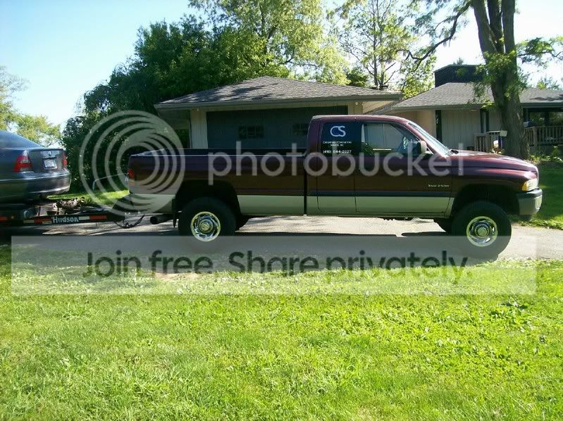

Looks-wise, the first gens, people love em or hate em :wink1:. I'm not a huge fan of them , but done right I have seen a FEW that I liked. 2nd gen is what your after then, 94-98.5 are the 12 valvers and the manuals are all 5 speeds (nv4500's), the 98.5 -02's are the vp44 pumped 24 valves. The vp44 has a bad rap, some of it deserved, but generally caused by bad lift pumps. My 00 24 valve has 290k on it (I bought it w 100k) , I had the vp go out at 260k, I replaced it and added a FASS lift pump, other then that it only has minor mods. I pull loads of 7-13k all the time and I can honestly say it does it great, mine is an extended cab long bed 4x4 with 33" tires and my unloaded mpg's are 20-22 and loaded I have never had less then 16-18mpg.
Just to pic whore a bit :D
Here's my 2000 with my brothers motor-less Jetta on the trailer :wink1:
that's a good lookin ride. would you have a moment to take a pic with the doors open so I can see how large the cab-space is behind the front seat?
