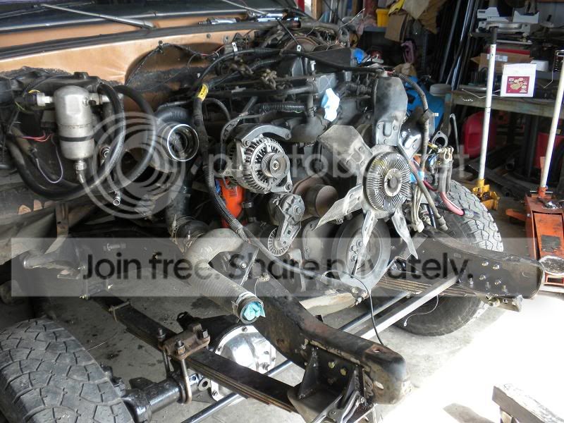

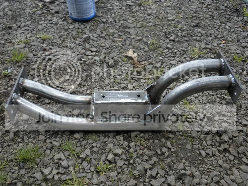

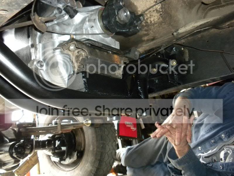

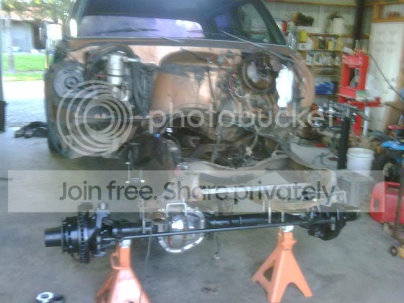

Here are some pictures.
After swapping from 2wd to 4wd with the Dana 60 in.
Cummins in the truck.
Crossmember I built for the transmission. I had to convert the NV4500 from 4wd to 2wd :doah:
Crossmember installed
I did do a lot of reinforcing of the frame. I've got crossmembers in 5 or 6 places from the front of the truck to the transfer case.
Thats just plain cool :D An old straight axle Chevy with a Cummins makes for a pretty unbeatable combination!
