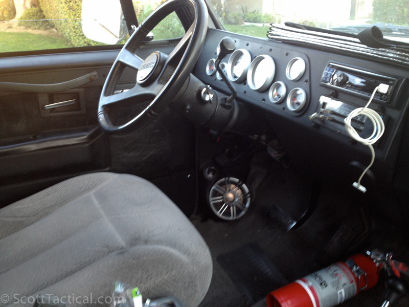

I decided to redo the kick panels on the door. They aren't super durable now since I just used the same speaker carpet as before, but it will work for now. I might put vinyl on it later if i get to it.
some pics.

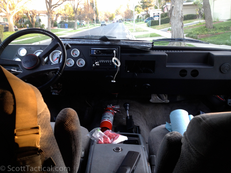

I decided to button everything back up. That wasn't easy.

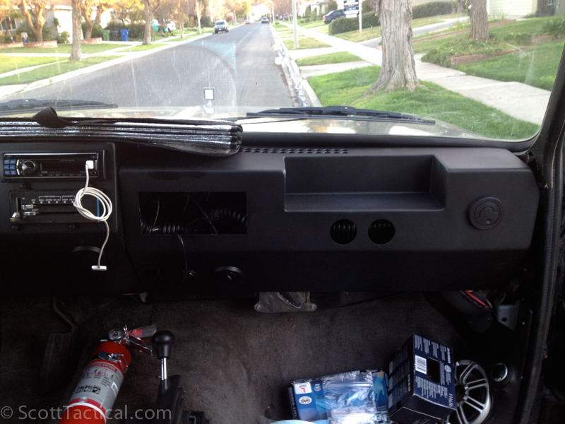

I DIY4X built me a dash off a mockup from Sketchup based on their design.
Sadly I think it's a pay product now.

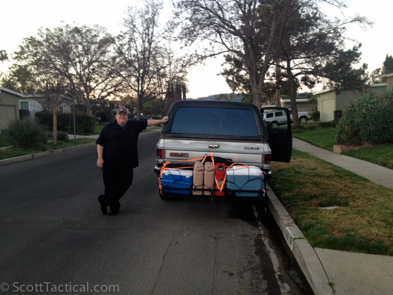

Right before leaving for that trip my radiator blew when I changed the fluid.
We packed in there tight:

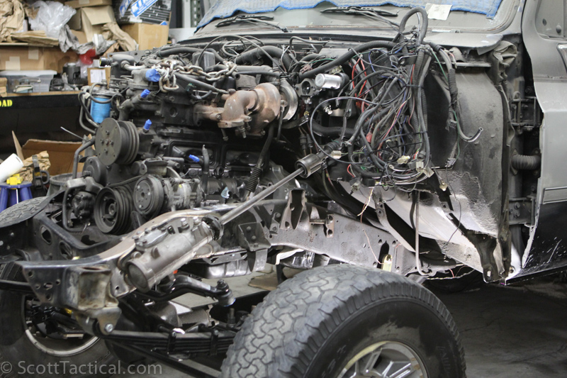

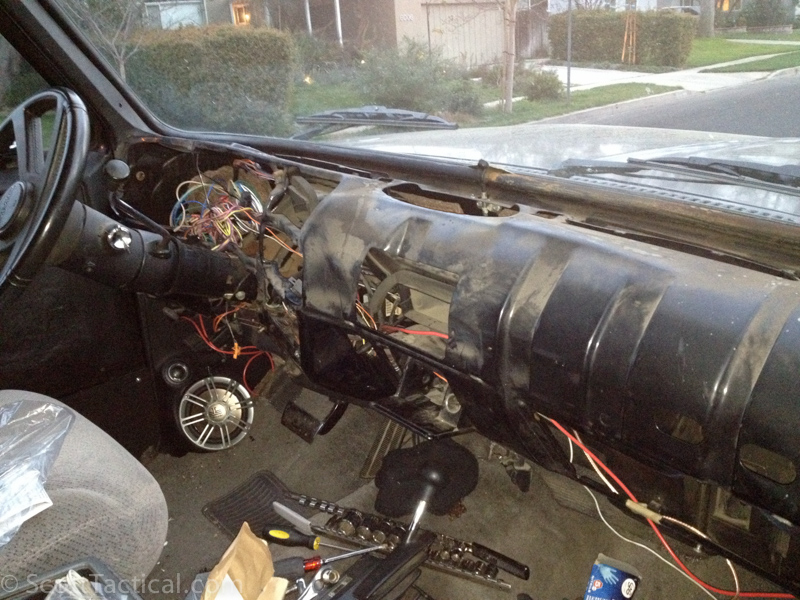

After I returned home it was time for the tear down.
I was working on it pretty much every day on the road and that was just not going to be a long term solution.
So, I decided to repower the the machine.
The 6.2L is a known problem and I wanted to try something new. I also wanted to apocalypse-proof the truck. Meaning make it sturdy enough to sit in my driveway. Actually I wanted to go on more overland type trips. So I wanted something strong enough to wheel out in the BFE and not break anything. I break a lot of things on this truck.

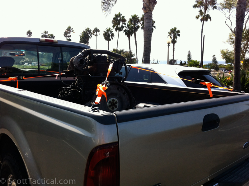

Next thing was to buy the Motor.
I decided that I would go with a 4BD1-T
  • good MPG
  • decent power for the size
  • analog
  • wide distribution in Latin Americas
That being said I found one.

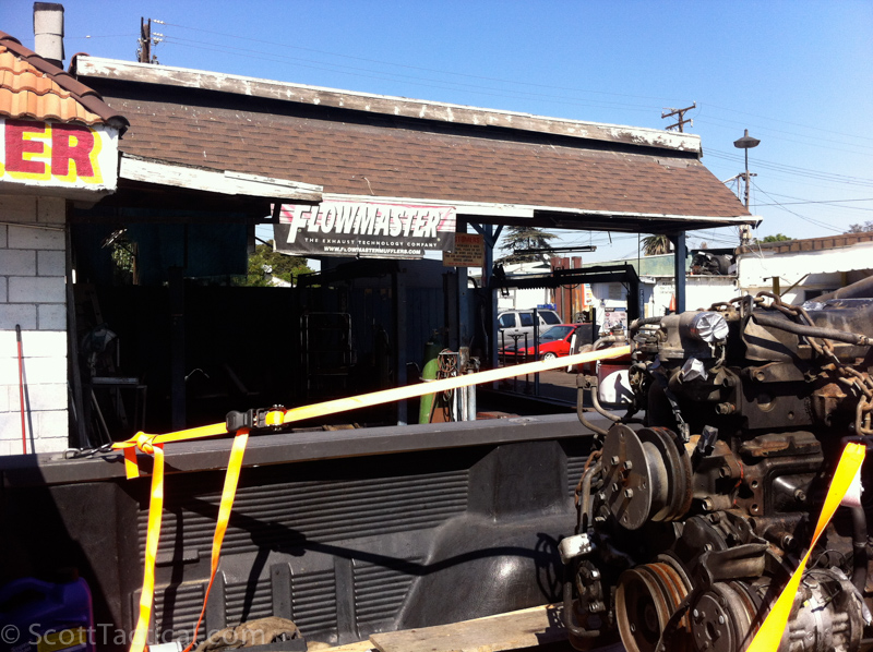

It was not in the best of shape and I had to have the injectors rebuilt.
I took it to this sketchy place in Compton.
Initially they wouldn't even acknowledge me since it was "lunch time". So I sat in my truck for 30 minutes while they finished. I spent the time looking for other places, but all the big commercial shops were outside of my price range and this place already started talking with me. Anyway they took a long time but eventually got it back to me running. New injectors.

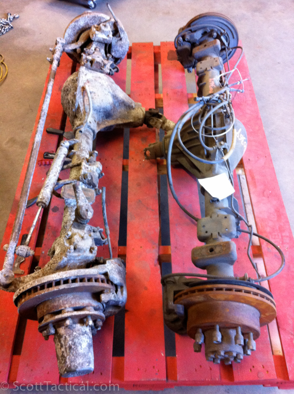

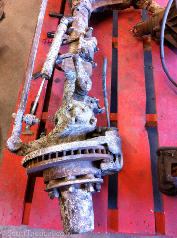

Some pics of the axles.
Straight out of Davy Jones locker.
Actually off a CUCV that lived in a paintball field.

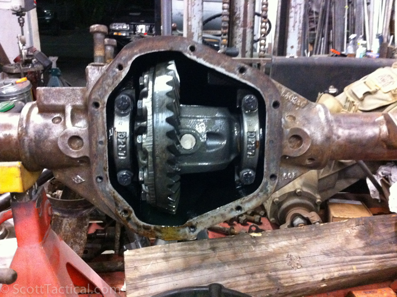

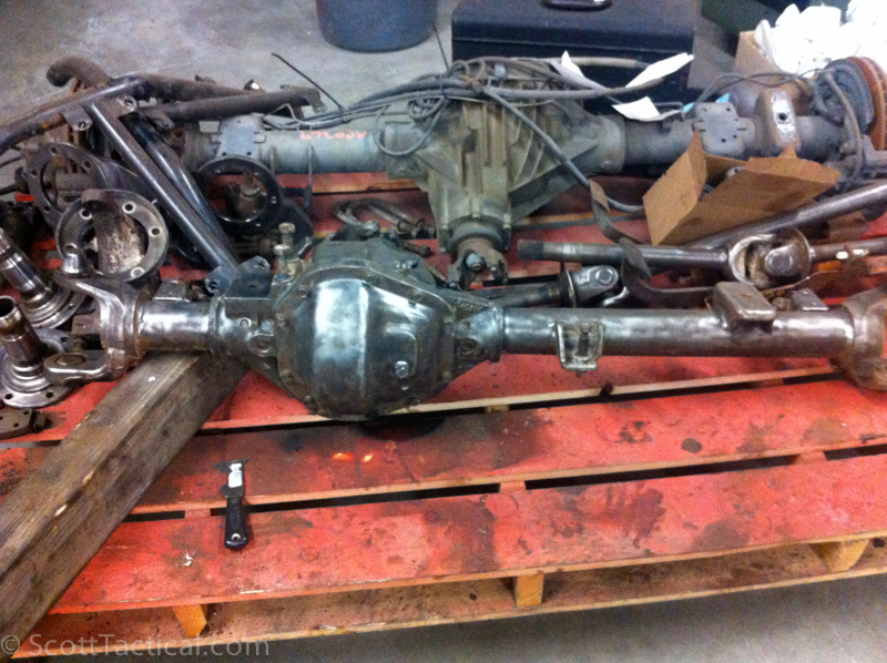

Went with a dana 60 front of course.
And found an AAM rear.
And all cleaned up.
This took days to accomplish.
Had to have Todd here help me pretty much on each step because I had never taken an axle apart to this extent. Just hubs or brakes.
I wanted to stay at 4.11 gears.
But the front of course are 4.56
The rear came 4.10 so I left it.
Front was changed by a local shop done at Todd's place.

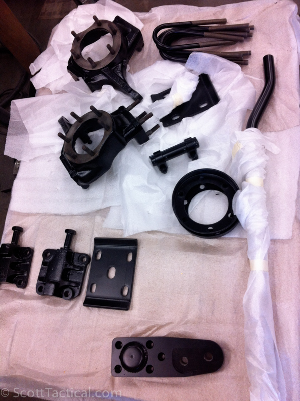

Parts coming back from powder.
I hope it sticks. Long story.
I'll post the finished front diff a little later.
