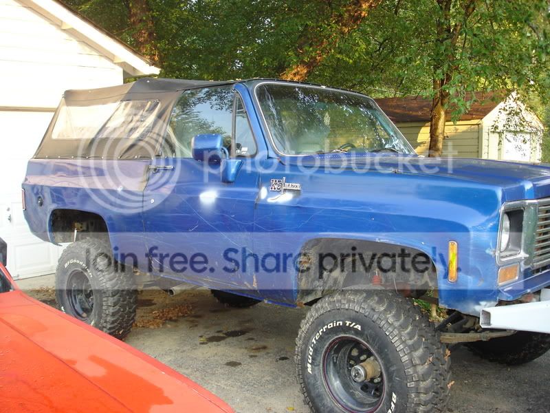

This has been a long time coming, but finally got my hard top off the truck, and my tigertop installed. :D
Looks good, what are the specs on the top and how was the install etc. Thanks

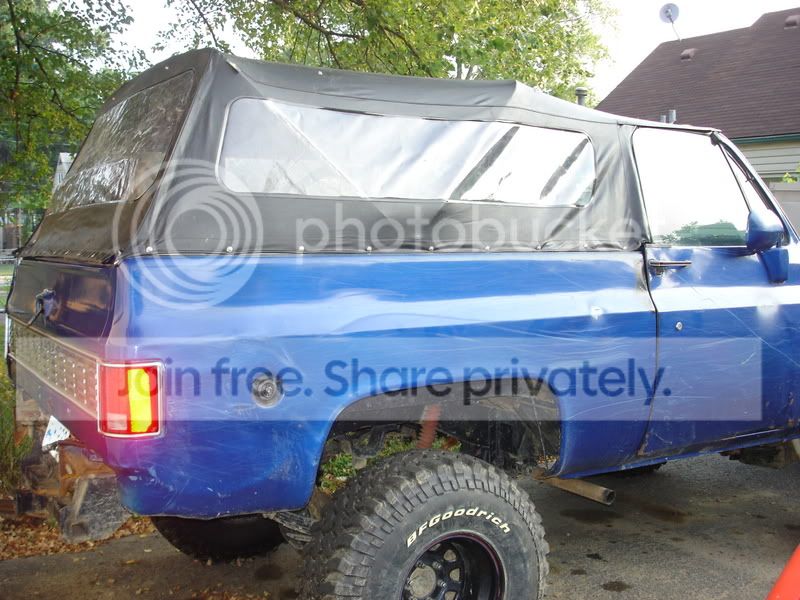

Specs.... um, its a bestop tigertop. Snaps across the windshield...
Install was interesting mostly because I didnt have all the parts to begin with. I bought the top used, and it came with the aluminum bed rails, canopy bows, and bars for over the windows. I had to call bestop and get some misc hardware (windshield attachment pieces, snaps, bolts for the rails... Total investment is about $280.
I started by attaching the bedrails using the existing holes and bolts. Then I drilled the holes in the windshield frame (GASP!!!!) for the snaps. Installed the bows and window rails, then started snapping in the softtop (had to do this in the sun so the top could stretch. Worked the corners and then down the bedrail towards the front of the truck.. I still have to install the tailgate snaps, and rear footman loops, and give it a good simplegreen bath. But all in all, it took me about 3 hrs once all parts were there, and if all goes well I doubt I will ever go back to a hardtop.
The best part about no hardtop was driving around and getting the "jeeper" wave from some tool in a stock yellow wrangler. I mean mugged him and kept on rolling. He don't know bout mah FULLSIZE VERTABLE!!!! :D
