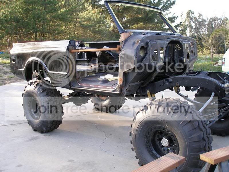

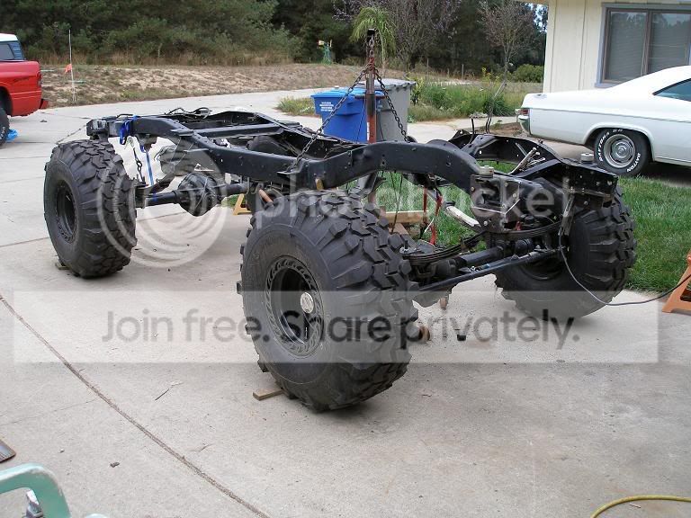

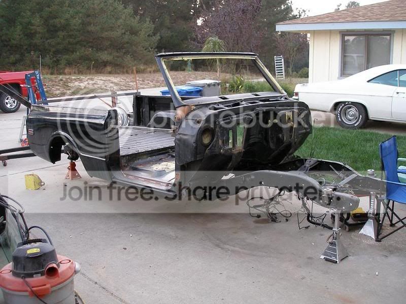

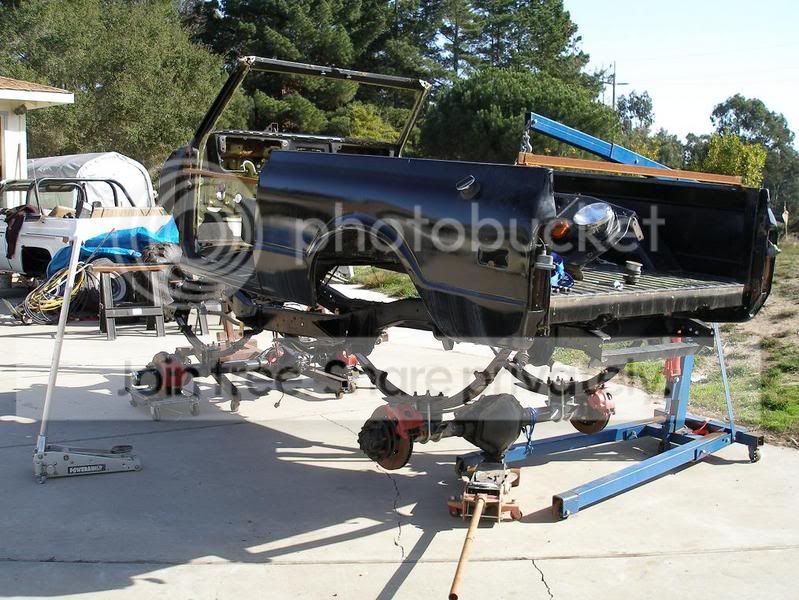

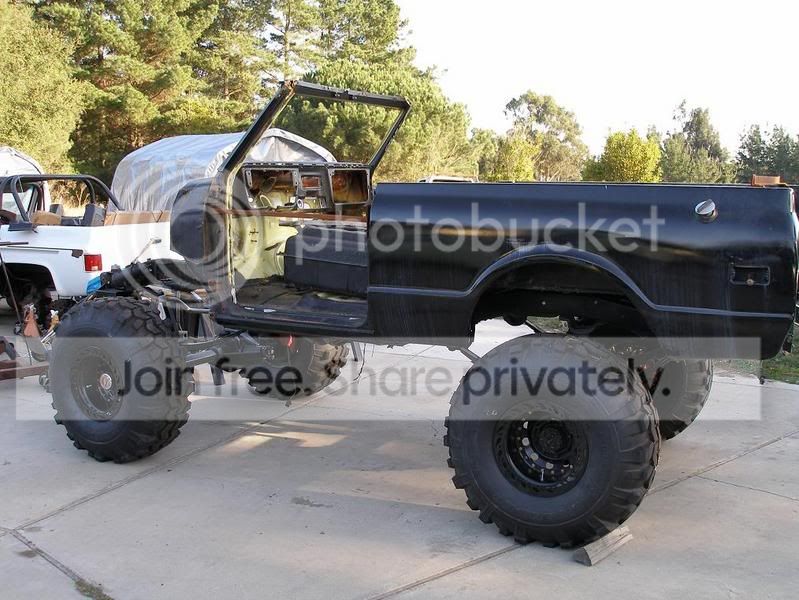

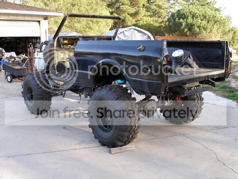

    This is a rough fit-up to get the suspension/lift right, fit the bigblock and aftermarket transfercase, fit xmember(s), etc etc.

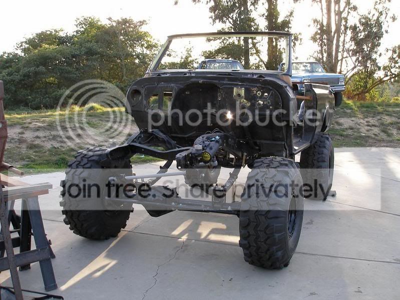

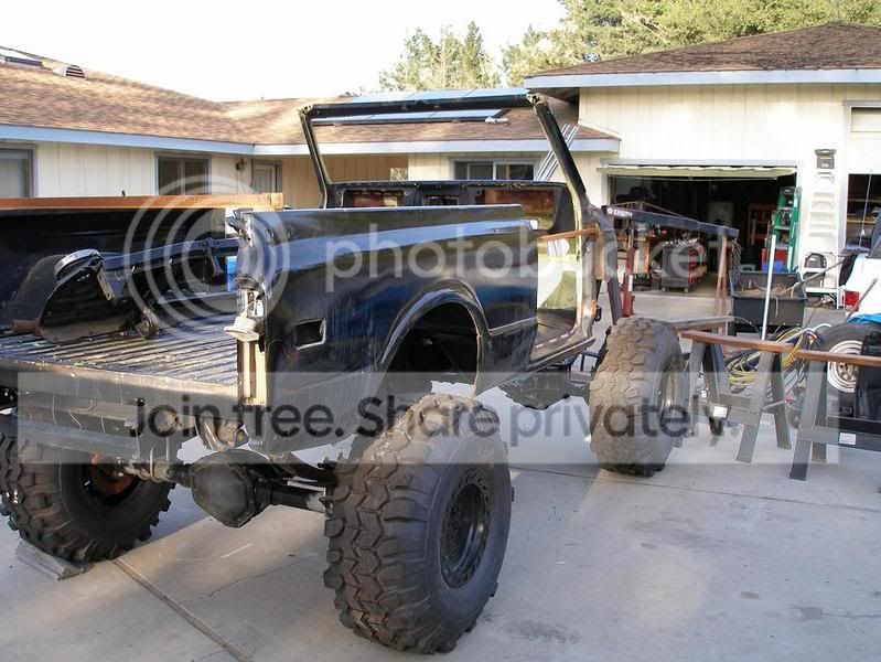

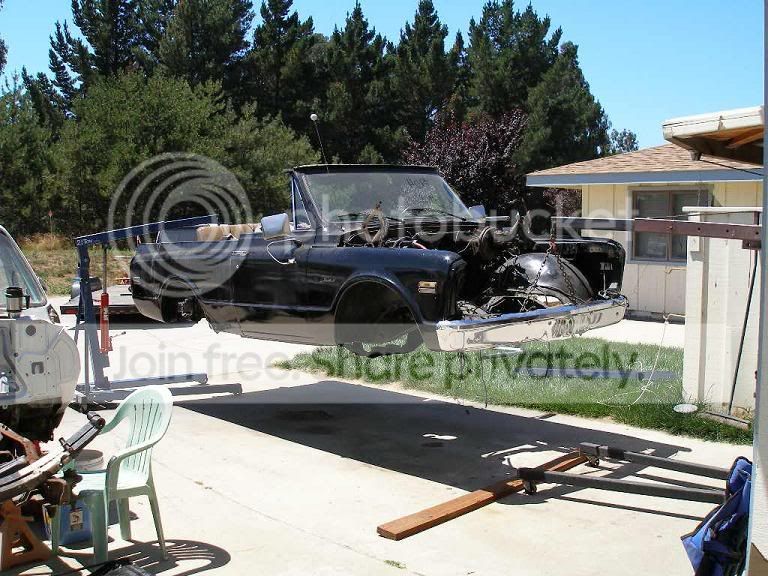

    We're putting the body back on temporary to fit up the motor (gonna move it forward I guess), fit the tranny and transfer case (need a new crossmember there) and to get ideas for a skid plate.
    Looks like I might need to trim the rear quarters ever so slightly. Dont really want to at all, but the thing is already getting massively tall, dont really want to go any higher. Also need to play with moving the rear axle back via the zero rates before I get carried away removing sheet metal.

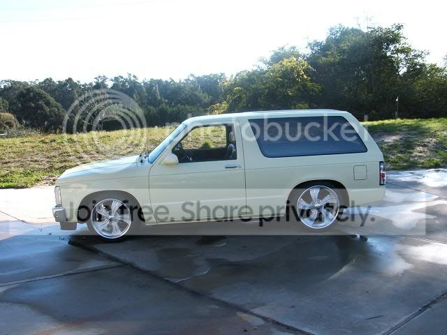

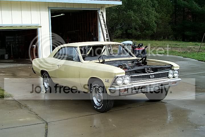

    Silly question for you guys, I want your opinion on the color. :D
    Originally it was yellow, like you see on the inside of the firewall in some of the pics. Since then someone has painted it a couple diff colors, the last being black. Im mainly thinking black, or the original yellow. I know, huge diff, and I keep going back and forth. lol I do like the original yellow, and going back to an original color has always been something I like doing, but there's a problem. I already own 2 yellow vehicles. lmao Seriously.
    [​IMG]
    and
    [​IMG]
    So do I really want a third yellow vehicle? lol Give me your color opinions please. :)

    What the....
    OMG! Are those blocks I see between the front springs and axle? If so, VERY BAD IDEA!
  20. 55Willy
    55Willy 3/4 ton status
    Joined:
    Jun 2, 2001
    Posts:
    9,946
    Likes Received:
    Location:
    Keizer, Or
    looks to be an angle shim and a zero rate. in which case the zero rate is bolted into the spring pack and has no ill effect on it unlike a block.
