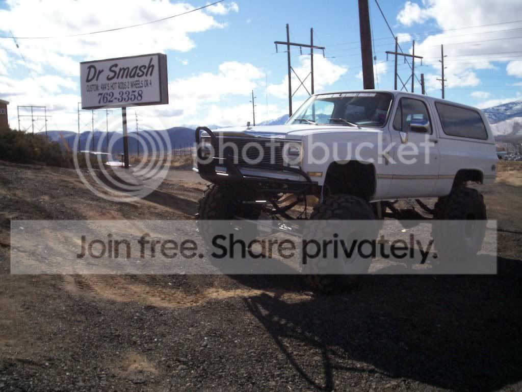

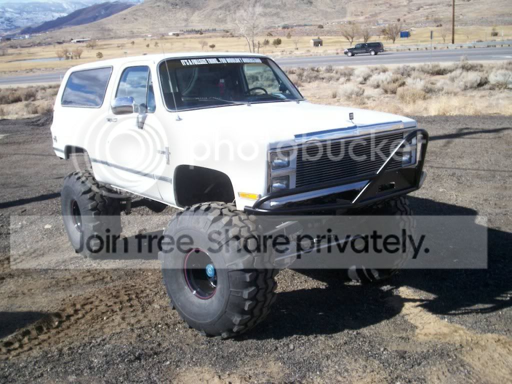

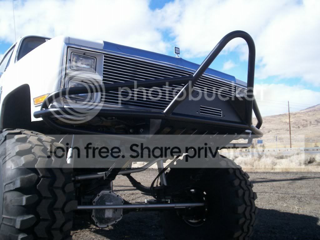

alright here are some pics that Eric, the guy who fabbed it up, took. I forgot to bring my camera cable home so i cant upload my pics but i will when i get back to my house where i go to school. Anyways, here is the updated painted version with the winch plate on and all welded up.

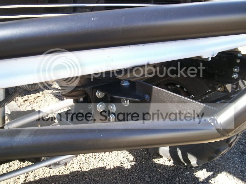

I forgot to take pics of the crossmember details. You can see it here-
the bumper mounts are welded to a 2x3 tube that fits snugly between the frame rails, bolts go from the outside, through 3/8" plate/frame/3/8" mount. It actually "sucked" the frame straight again when tightened up. I built mine to use a hitch mounted winch so the receiver tube is welded to the bumper and crossmember.

Anyways, that thing is tuff looking, thanks for posting up. I like the idea of the rigid piece between the mounting plates, I think i'm going to have Eric throw in a piece of tube between the two plates on the lower portions of them.

thanks man, i tried to not copy the whole front piece but i just loved the idea of the speed holes, it mixes it up a little from all the other bumpers that have a solid skid, and looks killer IMO
