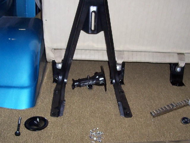

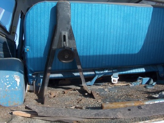

Here are a couple I've saved off the net.
