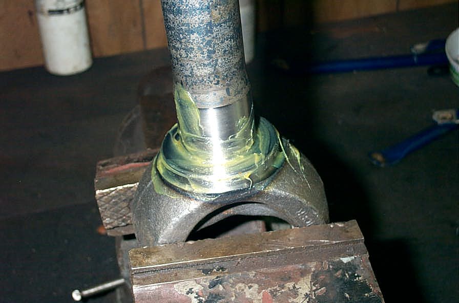

What is it and where does it go. I did not find them when I rebuilt my front hubs and spindles. It is on a 1990 k5 Blazer.
That’s a shield on the outer stub axle. It’s a non wear item so no worries unless you somehow damaged it or we’re installing a new stub (usually not included).

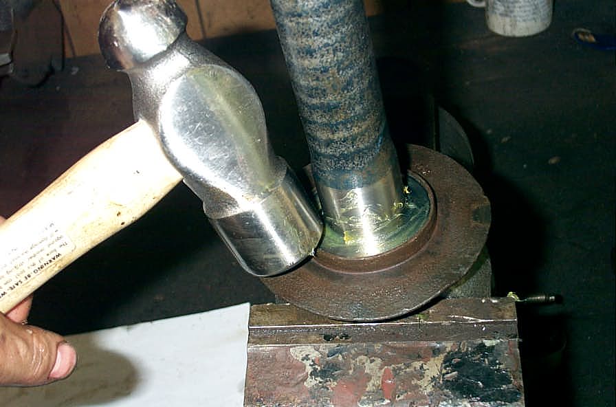

So does it go on the stub shaft before the spindle and backing plate are installed. Where does fit? I didn't see any when I had everything apart.
th
why that guy greased the stub shaft before install i dont know ? ? ?
and the dust seal that can be installed on it .
