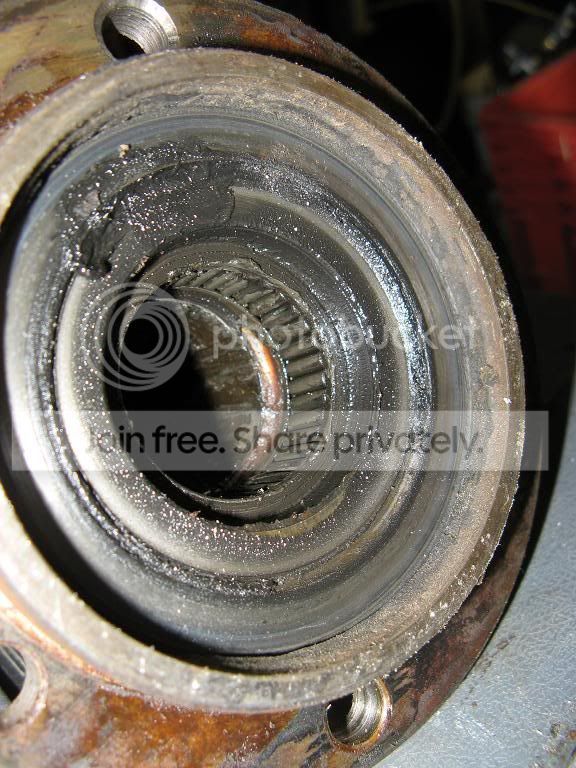

spindle bearing or wheel bearing, hmmm or axle bearing? Unless axles changed thickness, I'd think they all use the same axle/spindle bearing. The wheel bearings are what changed. IIRC
are you talking about this?
Yes that's it a sbk-4 fits it so that would make about a 70. I think. I picked one up from advance The # on the pumpkin 44 8j . I,m still cleaning it
If you need the spindle bearing pictured above just by longfields delrin replacements. It eliminates the bearing and the thrust washer on the shaft. Much less moving parts.
