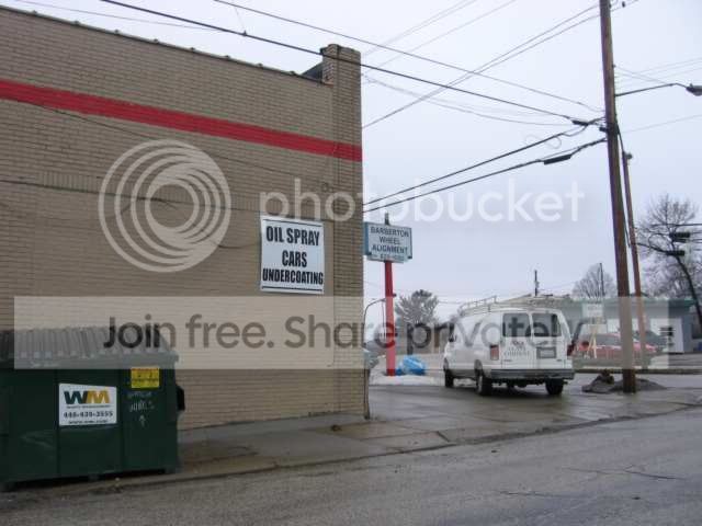

You don't see many spray "Boeshield" signs around here...
