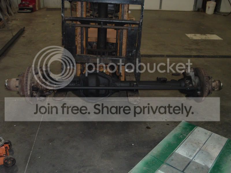

Don't know how well this will show, but the drivers side spring pad on my 60 is pretty rounded. Obviously this is how it was from the factory.
I guess I don't see how the rounded perch can contribute to a sheared pin. I could see how it could possible contribute to axle wrap, hence perches like Ruffstuff sells specifically marketed to help reduce wrap.
I know that there needs to be some radius to the corner or it'll create a stress riser in the springs. From what I understand this is why for example ORD's zero-rates have the radius edges on the top.
As for you buddy's problem, I think we often forget the unintended consequences of some of the mods to our trucks. Stuff like running poly bushings on the trans mounts and rubber on the motor mounts which for some has led to cracked bellhousings.
I didn't make the rounded thing very clear.
The bad perches were like half a ball type round. There was no flat spot or very little flat spot on them.
You are talking about the perches having a radius on the end and a flat spot about 3" long in the middle. The radius on the end is to reduce the stress riser deal.
