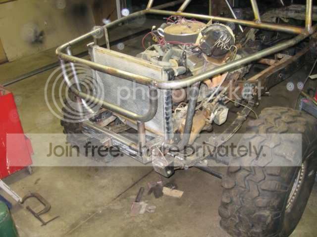

I started last march building my bluggy. I the frame was stripped of all it's worthless weight, and 510 lbs of tubing has replaced it. The fiewall was made from 16 GA sheet. I used the stock steering column, brake booster/master and moved them in 3", so the rig isn't so wide.
The design is my own, inspired by the formula toy and the scorpion.
More pics to come.:D :D

I've been cutting and notching tubing since july.
I've used 2-13 lb rolls of .030 wire
2 bottles of argon/co2 mix
5 saw blades for chop saw
10-20' lengths of 1 3/4" DOM steel tube.
1 4x8' 18 GA sheet
2- 23"x76" x 11 GA sheets
Now the interior needs to be completed.:doah:

looks alot like a formula toyota chassis
im diggin it!
Formula "Jimmy" chasis is what I'm calling it.:wink1:
It's 4" wider, 6" longer than the Hendrix chassis.
Also...it's boatsided.
