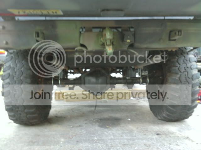

So i finally had a chance to tear apart the truck today. turned out to be a bigger pain in the ass than i anticipated. funny thing about old bolts they don't want to move. much like old folks on the way to the retirement home.
I'm doing the work at a buddy's house because i live in a condo with no garage. right now it is sitting on stands with no rear axle. waiting for tomorrow. kinda disappointing that i didn't get it done.
Ok, took longer than i thought but i was missing the spring plates and hadd to order them. got them from wfoconcepts.com great place to do buisiness with had the plates in two days with USPS shipping. and they threw a can coozie in the box :waytogo:
yesterday i got the rest of the stuck bolts out with my friends fire and mini sledge. not really looking forward to the front. seems like its going to be worse. way more rust upfront that in the rear.

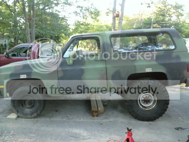

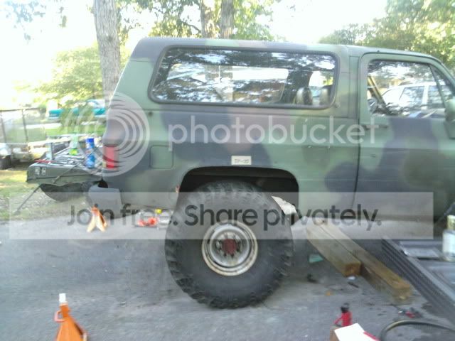

these wheels are temporary until i get my 37s in but now im not sure. the truck looks really good sitting that high
Is that all bolted down? How come the gap's are drastically different side to side?
