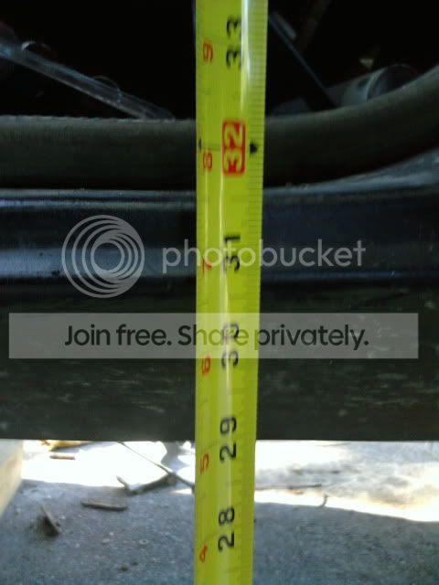

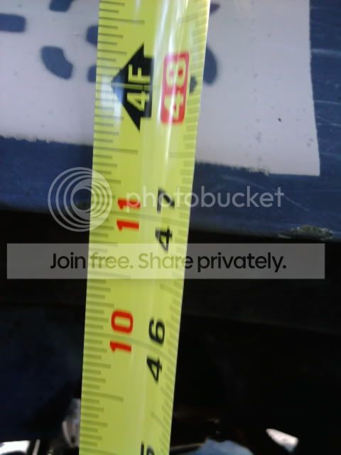

finally on 4 of the same size tire. they aren't my beadlocks but for now it will do. i have to still mount the tires to the wheels for the 37s but that can wait till i button up the truck mechanically. right now it sits at 47" to the top of the fender well.

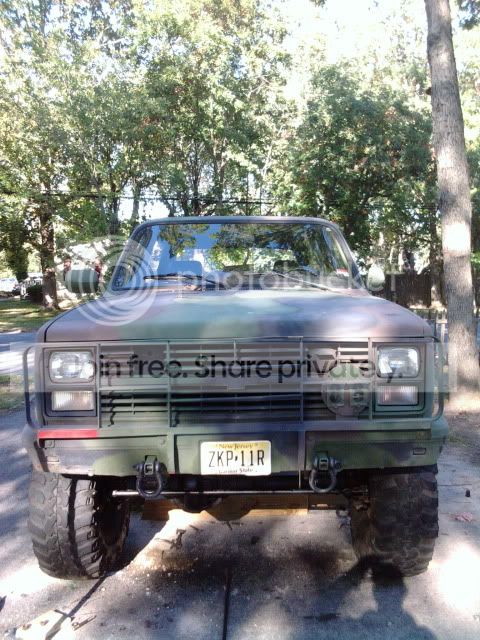

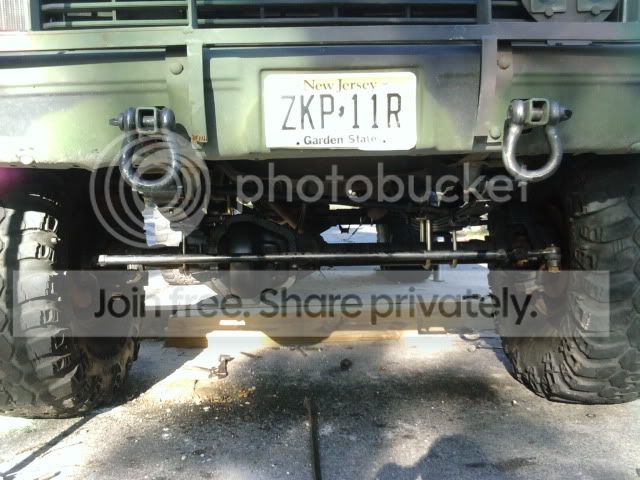

since you have the tape measure, check your alignment, I could swear you have the tires pointing out on both sides.:eek1:

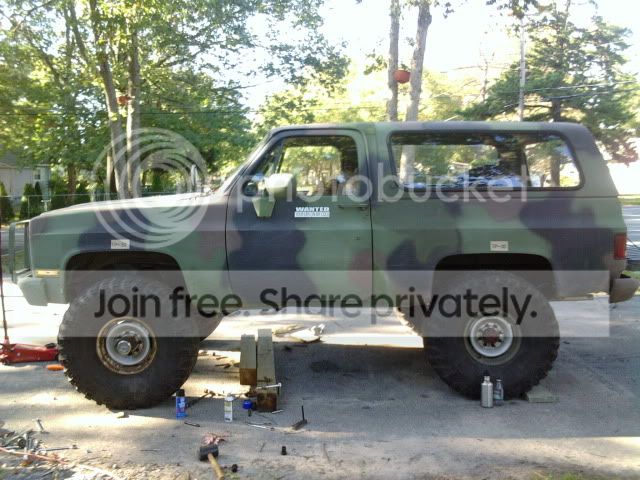

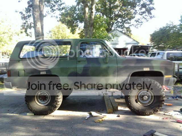

So what's up with the rear end? Unless the pics are just crazy it's definitely sitting sideways under the body. The driver's side looks like it's forward and the passenger side looks like it's back.
I'm with Avery, something is amiss with the rear install.
Rene
Yeah, im aware of the rear axle just havent gotten to it. i have slight ADD when i am working on projects. i see jump around a lot, when i see parts for another area of the truck i grab and go. i will get back to the axle eventually lol. :D

Where did you get your shackles?(the ones for pulling, not the ones on the leaf spring) I can't seem to get ones that fit right on my m1009.
