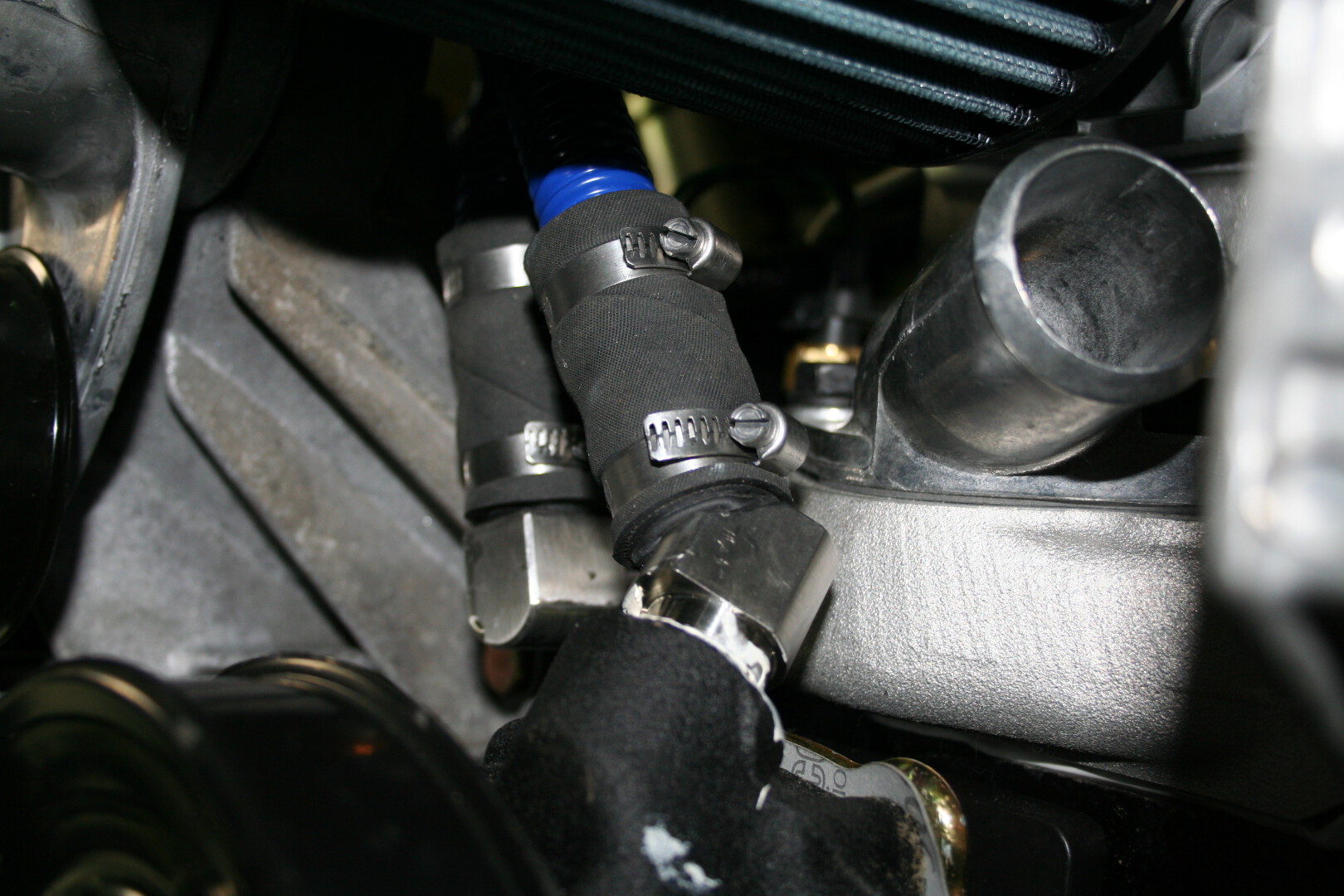

The RamJet has 2 places for the heater hose to hook to. ! is sticking straight up in the front of the manifold, but it so close to the fuel rail and riser you basically can't use it for anything, but I did manage to get a sensor in there for my stock temp gauge, no way to get any sort of fitting on that for a heater hose though, to big to screw it in.
The other place is right in front of it, but sticks stright out the front of the manifold, so I put a 90 degree fitting on that. The only place I know of to return it to is the water pump fitting which because the bulge in the front of the manifold, I had to put a 45 degree fitting on that (and I had to pull the water pump to do that!), just so I can get any kind of hose on there. Then because of the very close proximity of the front manifold fitting and the water pump fitting, it's rather a fight to get 2 hoses down in there and connect up. I could have turned the 90 on the water pump towards the drivers side and routed the hose up and all the way around over to that, but that seems like a big waste and looks convuluted.

I used the front manifold fitting there shown with the red cover, with a 90 degree fitting pointing up and slightly to the passenger side, then the water pump I put another 90degree fitting there. If you look closely there that whole section of manifold that the water neck is sitting on is sitting on a ledge out over the front of the block, that straight fitting he's got in there, I tried that as well, it about a fingers width from the edge of the manifold, so I had no choice but to put a 45degree in there.
Here's mine:
And here's a close up of them going down in there:
You can see the other provided location there under the throttle actuator where I was able to put a stock temp gauge sensor.

Even with the 90* fitting on it, still a bit trickey to clear my alternator bracketry, I can't imagine what it would be like if the other hose went to the water pump. :(
The stock water pump had the fitting on the top of the water pump pointed more towards the passenger side. This reverse rotation pump that came in the GM Kit has it pointing more straight back than to the side which coupled with the RamJet manifold bulge there really pimps an installer for hose routing.
