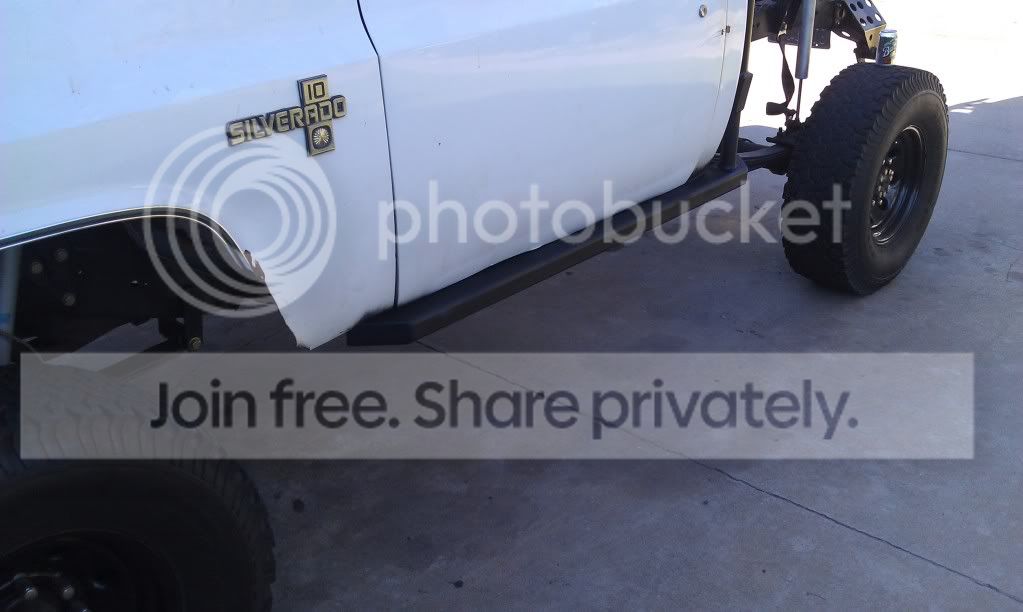

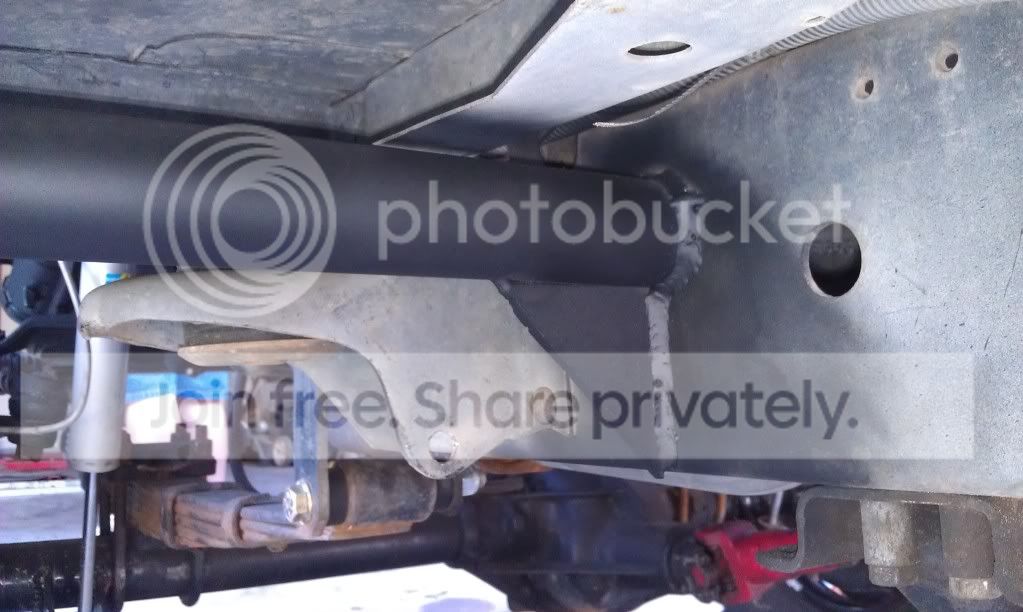

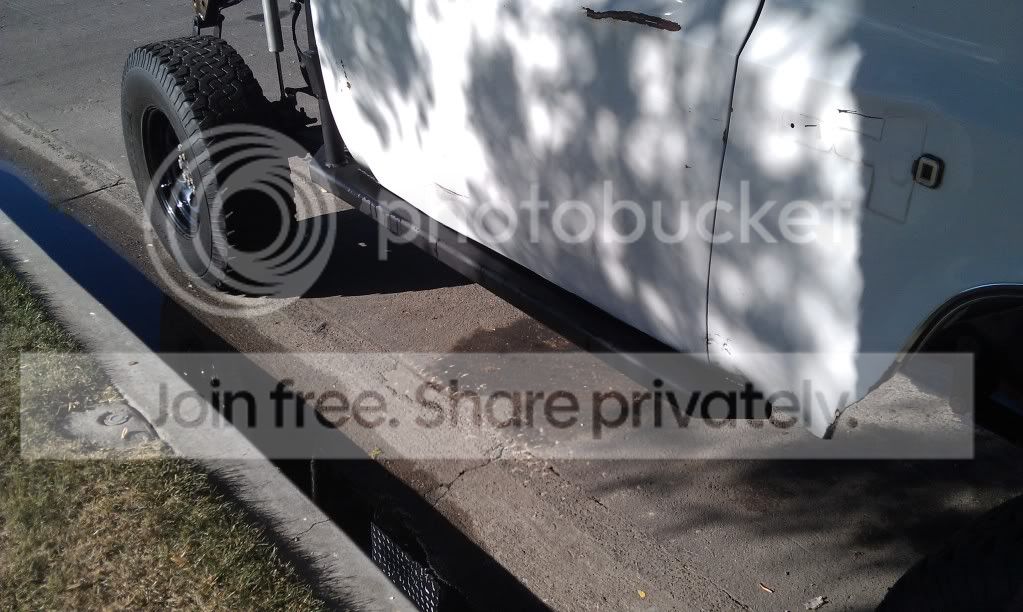

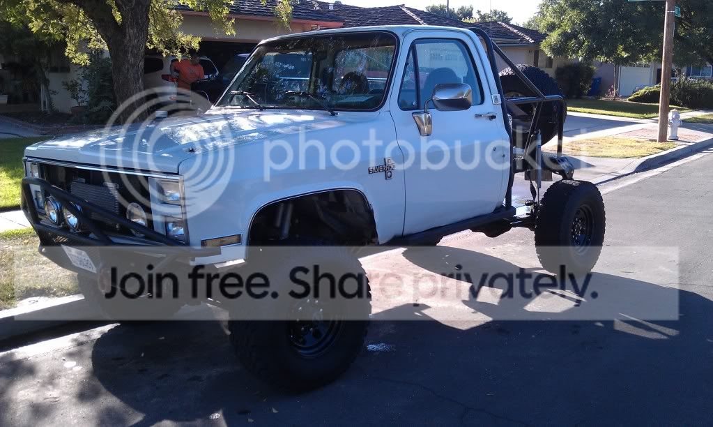

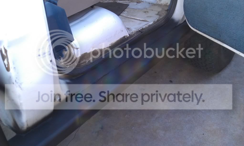

Did some more work on the k10 this weekend... figured it was time for some sliders before our trip labor day weekend. YES I realized after I got all cleaned up and inside to upload a couple pics that I missed a weld on that gusset. I'll fix it tomorrow after work. :)
It's official, I hate you. Out of pure jealousy, your cage is badass and your sliders, and your bed, and your spare carrier, and your suspension, and your truck in general! Seriously though, badass! Your a pretty good fab! I can see that skill coming to use :whistle: :deal:
easier to ask here then norcal..
are you gonna trim the fenders to match the sliders or did you run out of tube? lol
I left them there to give me room to grow. As long as I'm running 35's I'll leave them as is but I forsee a big jump in tire size once my front end is up to the task. So when that happens I'll trim them back to the sliders.
