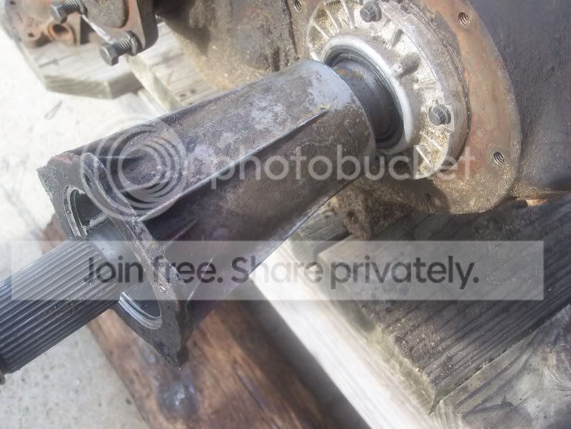

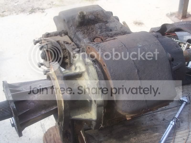

here is what i did with mine for some motivation.....
