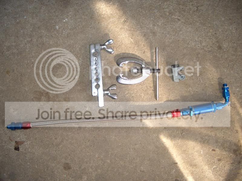

I'm looking to fix my "side of the road repair" and don't want to mess with bending a line from the pump to carb. I have been trying to research what fittings I would need to adapt this to a quadrajet but come up short handed. This would be for my 82c10
I would like to make something like this from the pump to a fuel filter then into the quadrajet.
Basically you have to search out the fitting adapters.
Not sure what size it is on the fuel pump but inverted flare is the type if I remember correctly.
Something like this,
