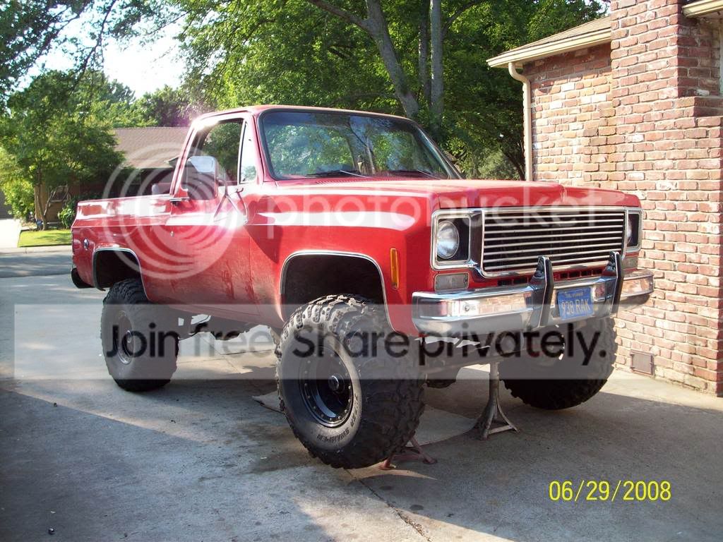

i took all the advice that came my way...and this is how she will be sitting until repairs are complete...
.....on jacks:doah:
