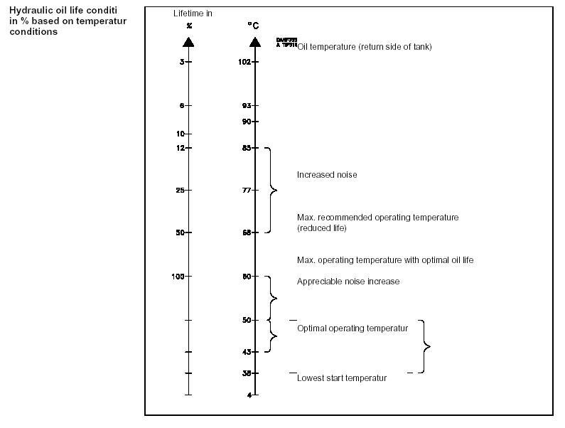

Pretty typical for ATF to be used in steering systems, there's lots of documentation as to what those kinds of temps will do to that fluid. They oxidize bad, the article by Billavista says 140 is generally the upper end of what is recommended and that the life of the fluid is halved for every 4.4 deg F over 140. At 194 the life of the fluid is 10% of what it would have been at 140 F, per the article.
